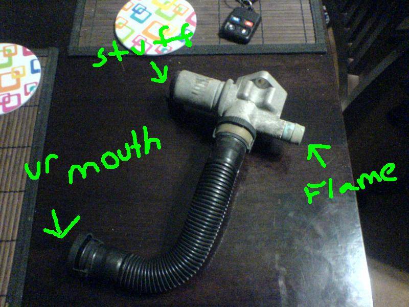

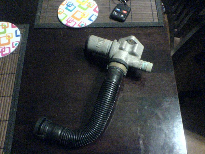

Can anyone tell me the name of this part
Found out what it was idle air control valve! It was pluged with carbon gunk.
LOL dj
You can usually use some carb/brake cleaner on those and clean out that gunk. I'd try that first before replacing it. I've done many of them when I had 5.0s. Just an FYI to save ya some dough.
Thanks i did that i use some carb cleaner. I posted about a code earlier it was P1120 and have changed the tps senor. haven't driven it yet will find out when i have to pick up the other half and see. But yeah around the plastic diaphragm there was carbon so we will see.
