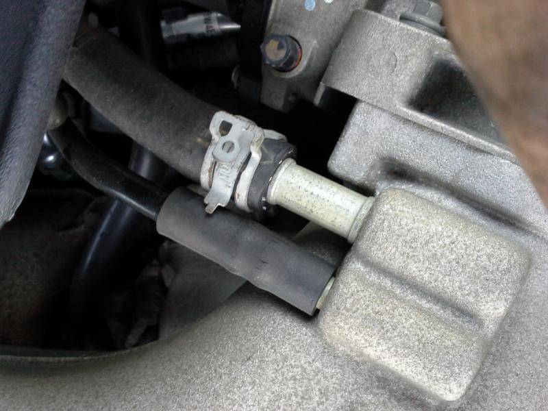

One of my vacuum lines on my 3.0 to the driver valve cover already cracked off so I replaced it, $35 on rockauto.
Now I noticed these are cracking off the top of the intake. It not bad but one is loose already and if you bend it the crack is almost all the way through.
What are they called?
The top hose looks like the coolant line. Yes, there is coolant flow through the TB to prevent icing. IIRC, the bottom line is a vacuum line for the PCV system.
Coolant line? Joy, that will be fun bleeding now. It looks fine in the pic yes but if you move it a lil its almost cracked all the way through. The bottom is the same but its loose. I figure better safe then sorry. Thats what I thought about the other line which had the same cracks but it was cracked deep and just ripped off until the car stalled:(
Confirmed, coolant and vacuum lines. Replace them if they are sucking air, but there is not much pressure behind either.
