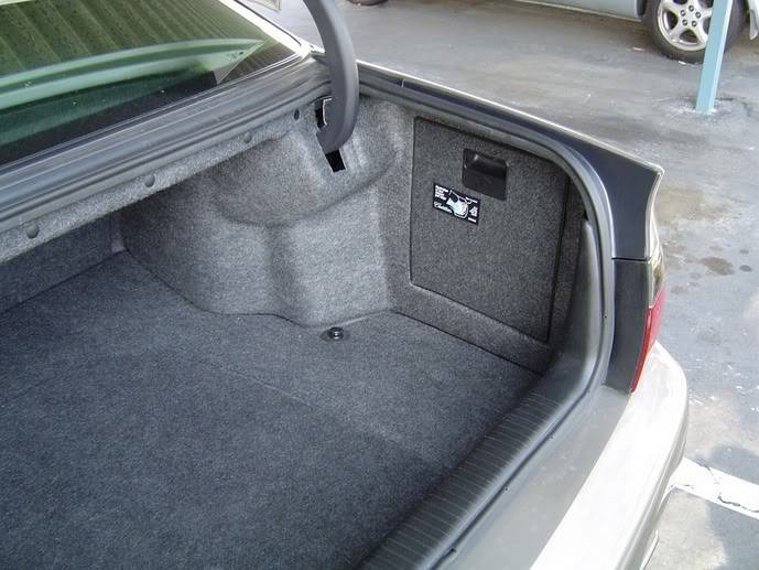

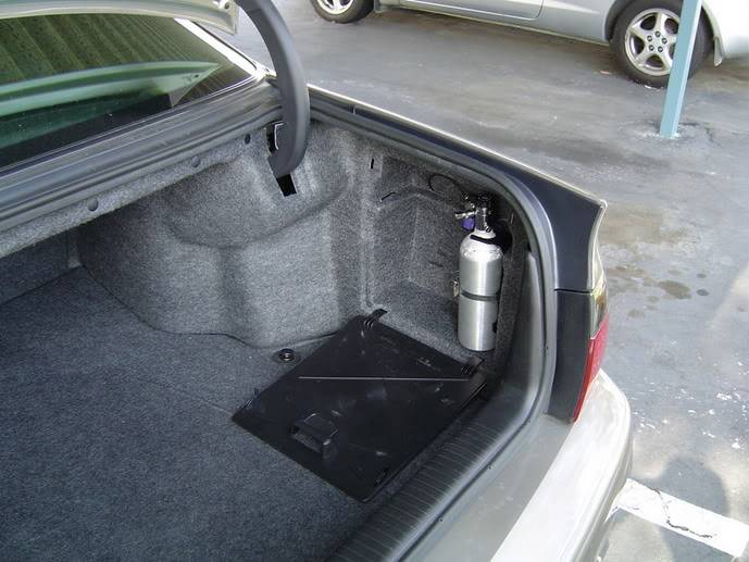

I bought this kit last week and took a lot of time thinking about the install. I like it a lot. Small shot and small capcity but when I don't need it, it's totally out of the way. Getting about 25HP right now. Not really noticable. I'm getting a bigger just soon which should get me 50-75HP. That's about as high as I think I should go on the stock motor.
Now you see it......
Now you don't.....
Very nice. That motor will live on a 75 shot all day long. Make sure the manufacturer of that system recommends the orientation of that bottle. You could be looking for trouble. Check it out.
Ohh yeah, great point. Most the time you have to have it at a 25 degree angle or something like that. . .
What is the reason for this?? 25 degrees towards the front or rear?? I heard that the orientation is because of the force during acceleration?? What kind of problems will I see if I leave it the way I have it?
It will give you surging affects when your using it. And I believe it can get worse. Im not forsure. You set it a 25 degreez and it has to be pointing at the front end. And you have to have it bolted to the car. Or you can't run at the track. I believe. . .
I also believe the nitrous feed line has to be pointing down to the ground.
Also, for a street driven car it should be in the middle of the car. Or not in a spot where if you get ran in to. It will not get hit.
Oh. Well, I ran at the track with that setup. I told them I had the N2O but they didn't look at it. As for surging?? What exactly is that. It seemed to operate fine for me. even though the shot was not really big enough to notice except at the 60ft.

Here are the acceptable bottle installs -> http://www.zex.com/Technical/Instructions/DryNitrousKit/DryNitrousInstructions.pdf
page 2.
normally - the bottle is installed with offset backets which holds it in position A.
