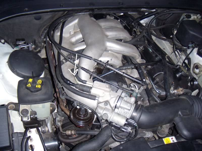

here is the hose i need.

That arrow is kinda in the way and I'm not familiar with the V6 motors, but does that hose seem to make a U? If so, you should be able to get that molded hose from a local parts place (read: small parts place, not PepBoys, AutoZone, etc.). If not, RockAuto.com has the hose under the "emissions" section for your car.
