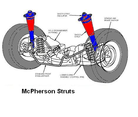

...struts...
:shifty:Really?:rolleyes:
McPherson Strut suspension design.
