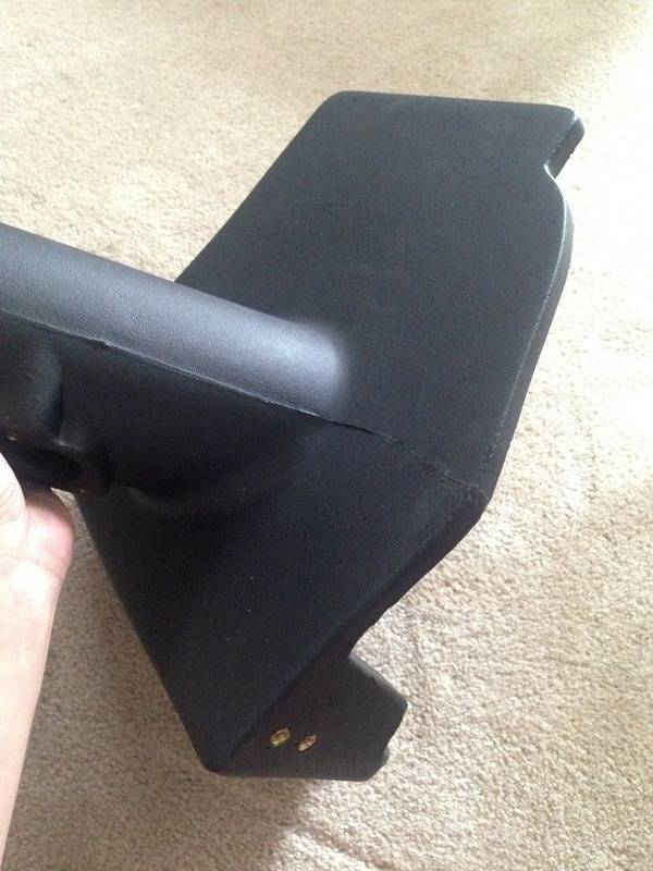

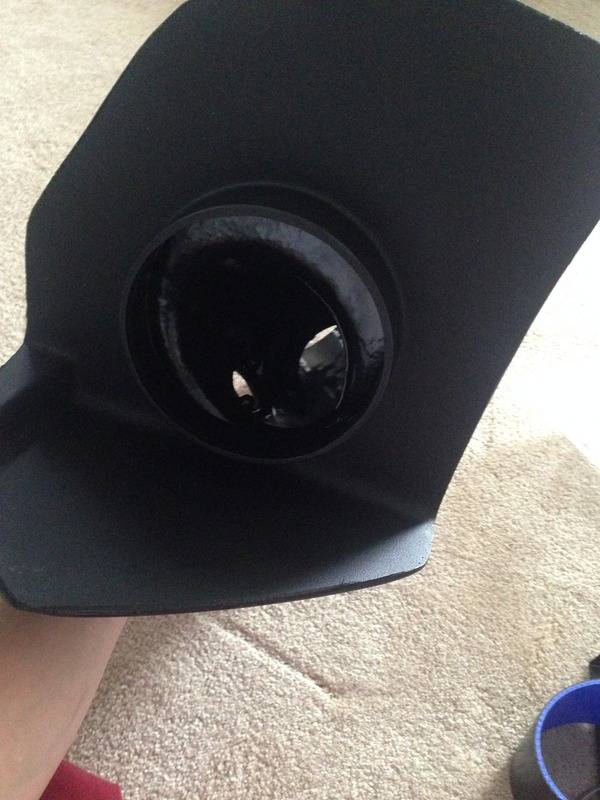

-the quality of the housing is a really cheap plastic and has no type of heat shield which may have caused the intake air temp to go up FAST when I was at a stop light.

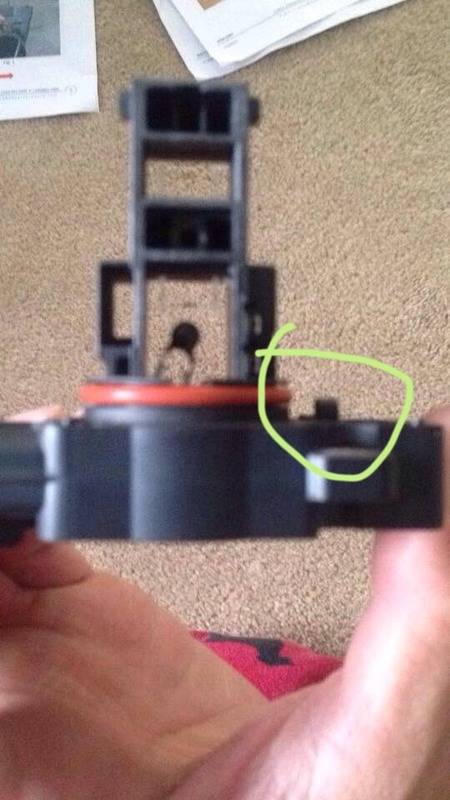

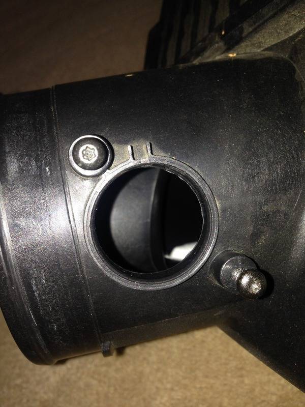

-the MAF sensor won't fit flush unless you sand/grind /cut that part off (I wasn't too happy about having to do that ) since the corsa didn't have the indentation for it on the intake.

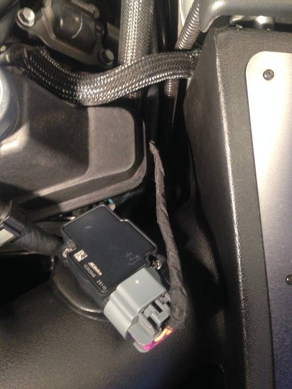

-the MAF sensor harness is so tight that there is no play / wiggle room , I'm afraid when the motor moves under load it'll pull on it stretch out the wires and eventually rip it and cause issues, Jon told me this is a easy fix by just unclipping the zip tie that's around the harness. ( I'd prefer not to do that )

MAF sensor , I circled the part that needs to grinded
Stock intake with the notch / indentation

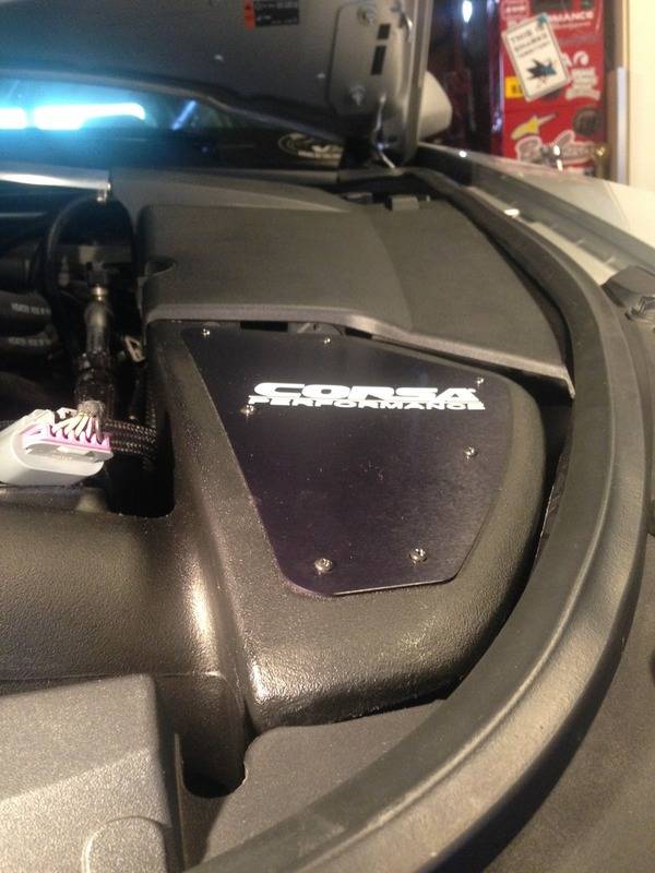

corsa (sorry it's kinda hard to see)
MAF sensor harness no play

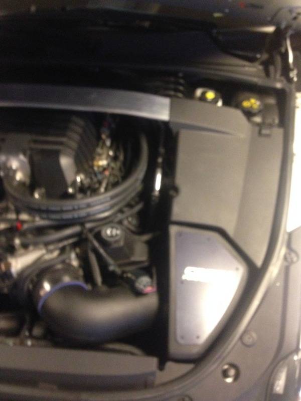

This is what it looks like when your done , I've also tried adjusting / reposition it certain ways but all comes out looking this .
Corsa metal plate can be removed , it's just a tiny Phillips screw .

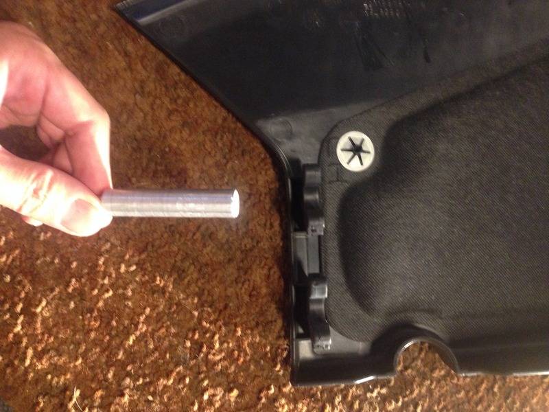

I used one of these to go into the grommet and fits perfect and attached a hose to connect the the catch can.
