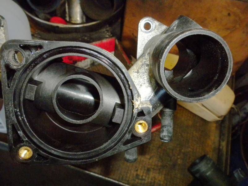

Since I was already tearing the engine apart I decided to tackle both jobs at the same time. DCCV wasn't so hard to replace. It was a :q:q:q:qing mess, but it wasn't so hard... as long as you have the hose clamp pliers, and a few 1/4" extensions...

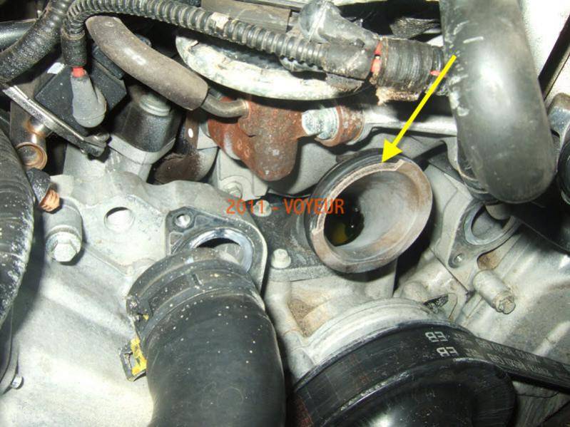

The problem turned out to be the thermostat housing itself. One of the plastic tabs that holds the thermostat in place broke, preventing the thermostat from being able to open properly. From where I found the plastic piece, it looks like it had jammed the thing close. The thermostat is still good, but I will replace it anyway since I already have one and the engine is torn apart. Problem is now, I don't have a housing, and I'm sitting here without a way to go get one.
will the housing close up without leaking? Can you get t-stat in? It may not have to be perfectly centered as long as the o-ring seals.
post a pic, might be able to hack it together temporarily to get you going...
Turns out I was wrong about the thermostat. I went back and examined it... and yea its locked up. Wouldn't even budge with me using pliers. I suspect it may be what broke the housing. My dad is on the way out here so we can go to the Ford dealership to get a housing. ($57)

glad you are not stuck and have a ride. Yeah, there's no o-ring on the gen 2 t-stat (unless you removed it). I still can't really tell if its open or closed there.
