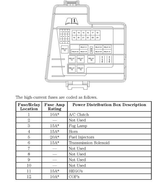

I checked and the horn fuse is in the fuse box under the hood. It's on the left side of the engine if you facing the front of the car. The fuse is in the #4 slot. Pull it out and check it to make sure it's not blown. If so, replace it with a 15A fuse. The relay that runs the horn is also in that fuse box. It is in Relay 06. I don't know if you'll be able to check that or not but it's more of an FYI thing.
Check the fuse first and if it's ok then move to the actual horn.
Here's a diagram of the fuse box under the hood:

I have this problem as well. The horn relay is in the power distribution box, which is mounted on the leading edge of the passenger-side front wheel well. It looks exactly like Ken's diagram.
I want to say the horn relay is relay 13; the easiest way to find it is to open the PBD, then start pressing the lock button on the remote repeatedly. You should be able to locate the realy fairly quickly--it'll click twice each time you push the button (after the first), since it's trying to honk twice to tell you that the hood is open.

I didnt see the fuse in the diagram. Ill take a look. Im figuring it has to be a fuse, odd for it to go out, but i have a habit of using my horn:D .
