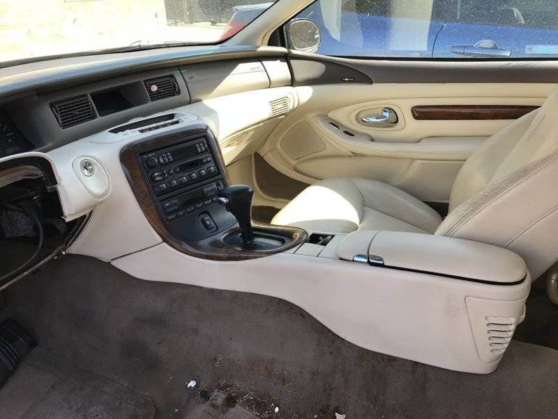

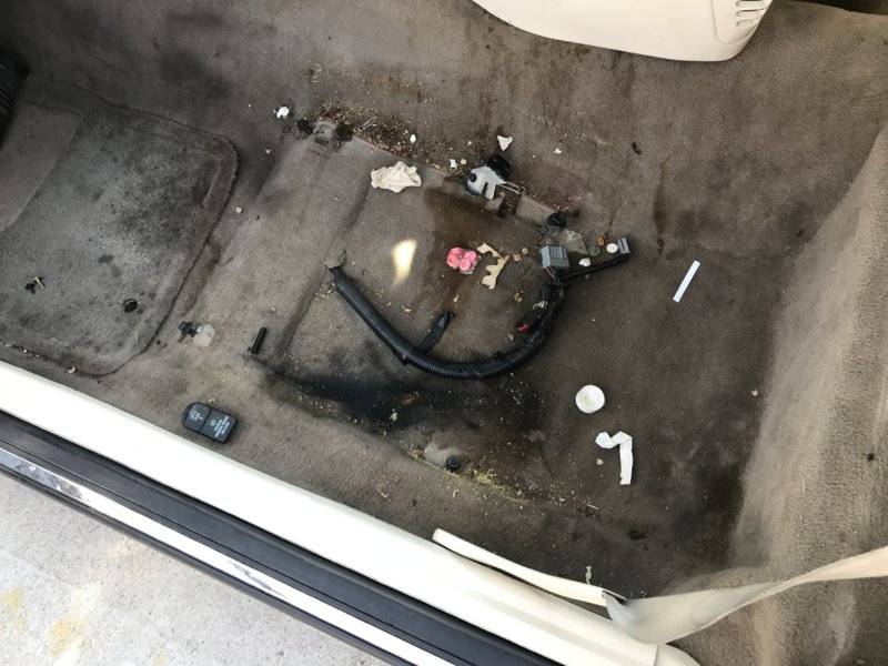

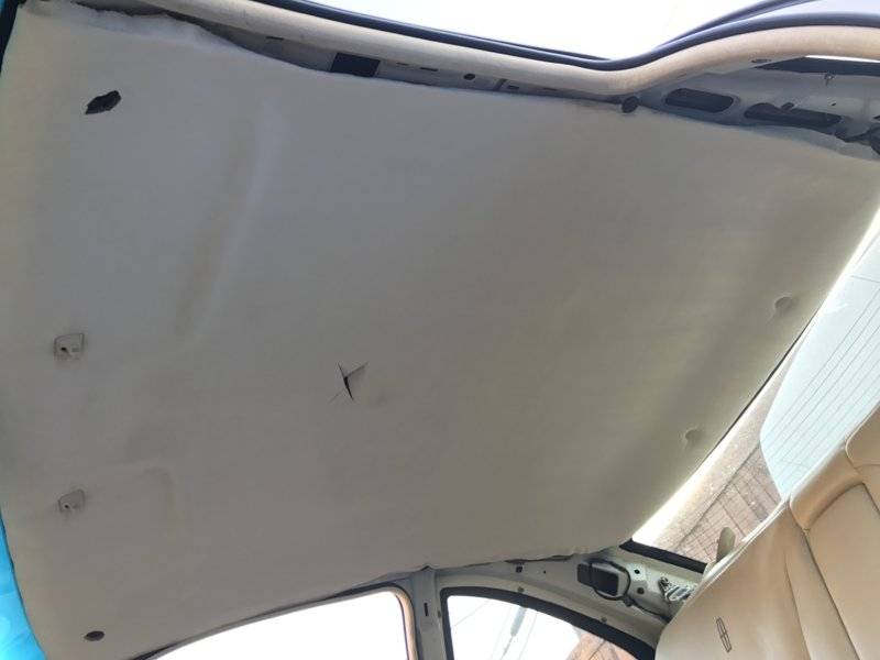

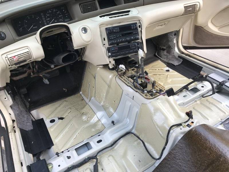

I currently have the interior stripped so that I can clean it, re-dye the worn leather, make repair to the mounting or retaining tabs on certain pieces and paint any worn pieces as well.

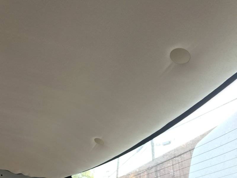

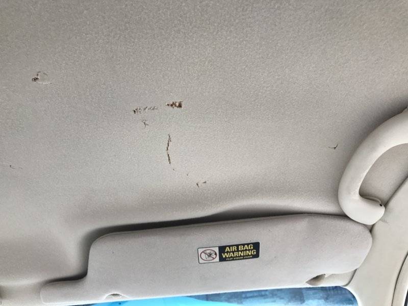

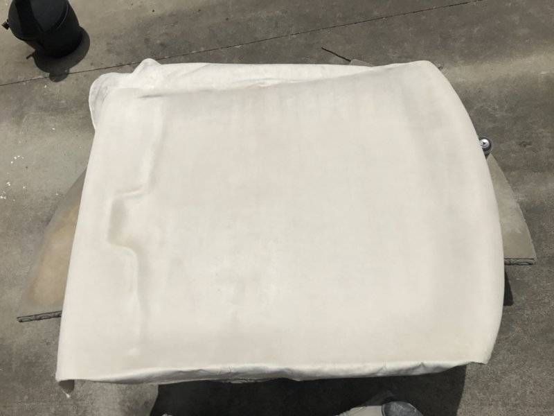

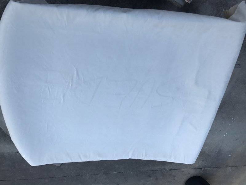

My first priority for weeks now has been finding the right headliner. Once the headliner is in, the rear panels, parcel shelf, and newly conditioned rear seats can all go in.
I didn't like the options for headliner foam that I found. At first I was thinking a basket-weave or lace pattern like modern cars (stiff rigid fabric). But I was trying to find a matching ivory color in anything and I just happened to stumble on this faux suede. I took it for $7/yd. and haven't regretted it thus far. I should have it sprayed and in place tomorrow.

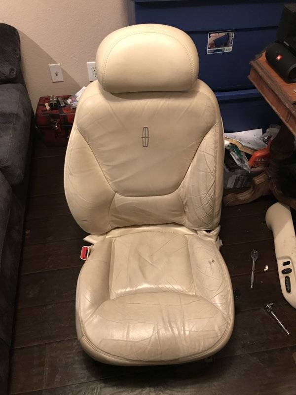

Q: How can I make the nap stand on end without necessarily going one direction or the other? Real suede shoes or nubuck seam to have no nap direction until you touch them, they're very good at standing on end.
Q: Since one of the gears is stripped in my seat gearbox, are there any easier solutions besides breaking the rivets and diving in?

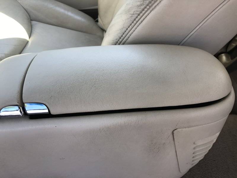

Q: As you can see, the outboard bolster of the driver's seat is worn to much that the foam is dangling and loosely hinged. What is the easiest repair for this foam?

The seat foam any upholstery shop can also do this. I want to point you toward Temple Performance and Super coupe performance, they specialize in many resto parts for Mark VIII's. Including the interior. Links: Mark VIII Muscle Super Coupe Performance Parts| Hoods / Leather / Carpet / Rubber Seals / More
You can buy a new gear assembly if you can't salvage one. You have to determine if its to much money or not for new. At least you know its like brand new.

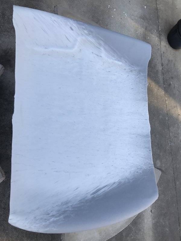

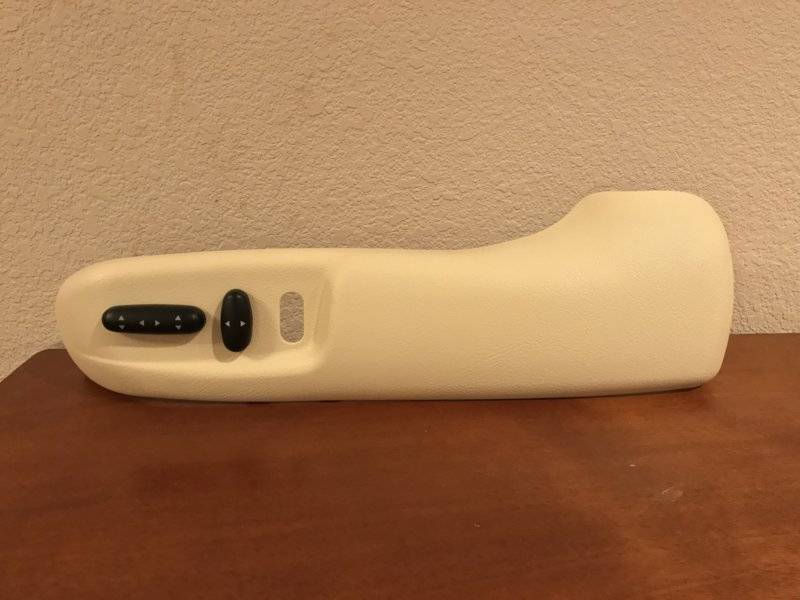

Here it is, and for being a piece that was found on the rack, it matches amazingly well to the factory plastic. I could only be happier if it didn't get some bubbles while it was curing. There is a small streak of them and no way I can think to flatten it out.
If I did it again, I'd glue the suede to the foam first, so that there is more rigidity to work with when laying it out and rubbing it smooth.
Looks really good.
Sometimes its hard to "iron" out the wrinkles, when doing things like this. You did a hell of a job.

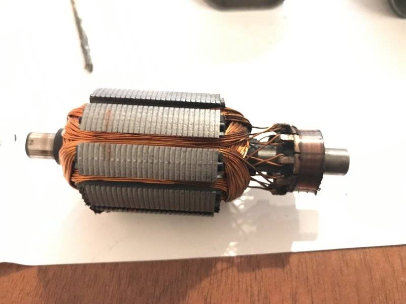

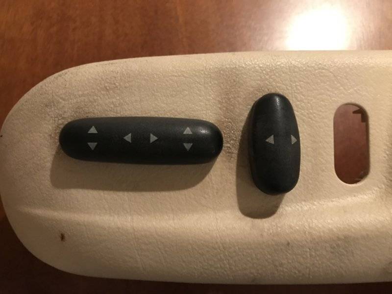

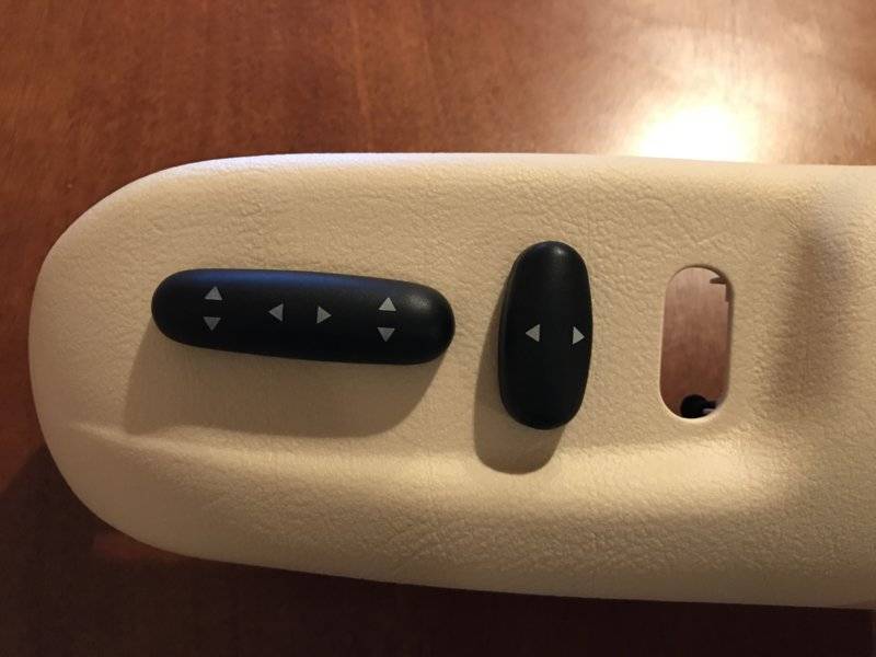

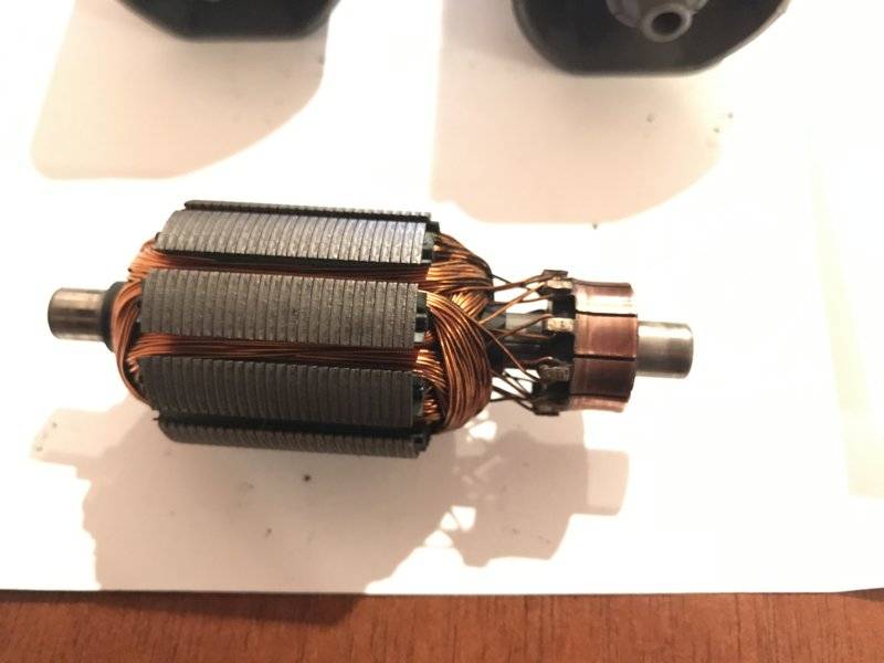

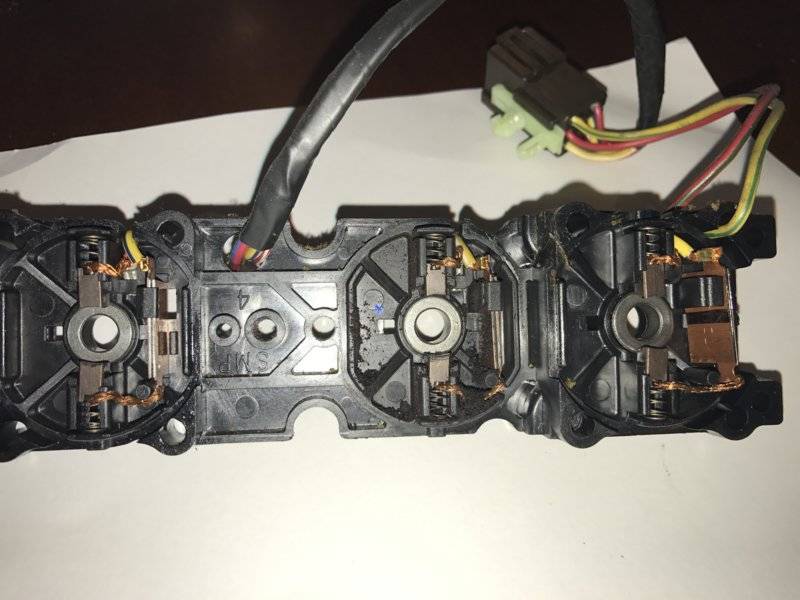

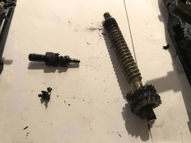

The seat doesn't move forward. I can hear the motor move whenever it tries to move at all so that's the bad news.

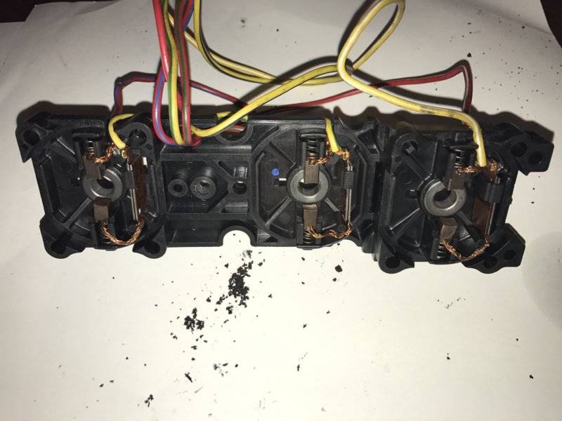

I took the motors apart and cleaned the commutators. Because the forward/backward drive motor is the most worn, I switched the windings and brushes over so that one with a bit more meat could go to the most used function.
There was so much carbon build up on the forward/back motor I had to thoroughly clean all of its components.
Turns out these worm gears are both worn out. I would need to replace both and it should work fine. For now I'll look to see if it's possible to buy the gearbox without the motors to save some scratch.

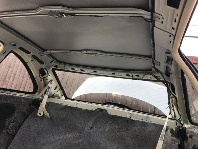

I have very little to update as I'm waiting to tackle the seat-belt webbing before I install the rear panels and seats. They will have to be thoroughly deep-cleaned and I may even use steam, and then wound tighter so they retract properly. I'm also going to remove the middle belts from the sleeves that they share with the other buckles and tuck them so that they will be out of the way but accessible for that 0.01% occurrence that I have a full bench.
So for today I just cleaned a bunch of the plastic in the tub. I use Dawn dish soap, a vinyl scrubbing brush, Mr. Clean magic erasers (I can believe it's magic), and in some cases I use mineral spirits to clean up oils, greases and plastic or paint transfers.

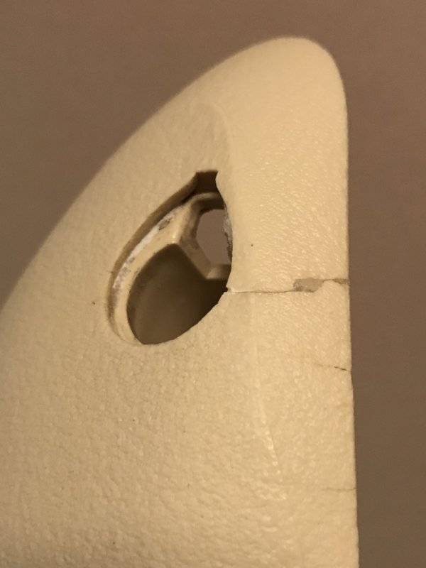

I had to reattach the bosses that are used for the screws and push-rivets. It seems that almost all of these are broken on every Mark VIII I encounter. Pretty common, maybe it is a flaw?
Anyway, some cyanoacrylate and baking soda made the bosses so stiff that I can hold this seat trim piece horizontally holding just the boss. As well, I filled a small missing chunk in the front of the trim piece with the baking soda and then dropped some CA there. I smoothed it out so that it dried without leaving any sheen or texture. I'm happy with how good it looks and don't feel the need to paint unless I find a killer plastic dye that would match.
