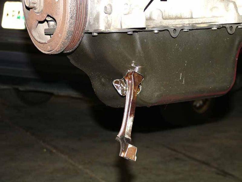

This is usually what happens (or similarly) when you throw a rod.
You get awesome parts to hang on your garage wall.:headbang:

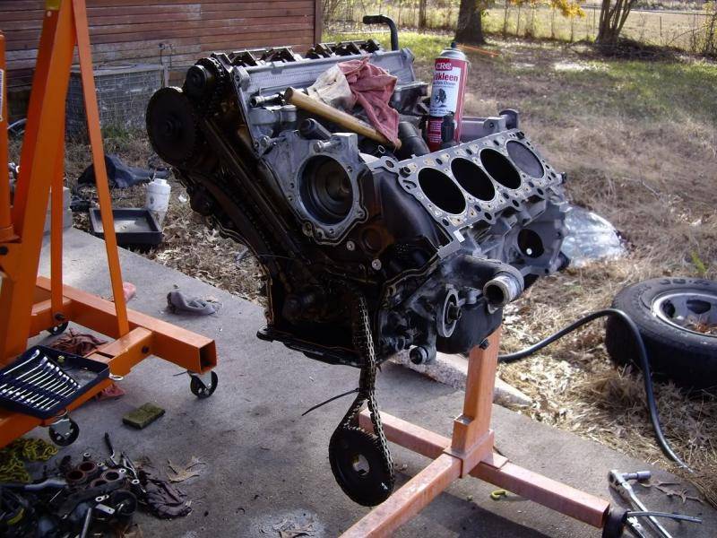

*Adding your picture for refrefrence*
