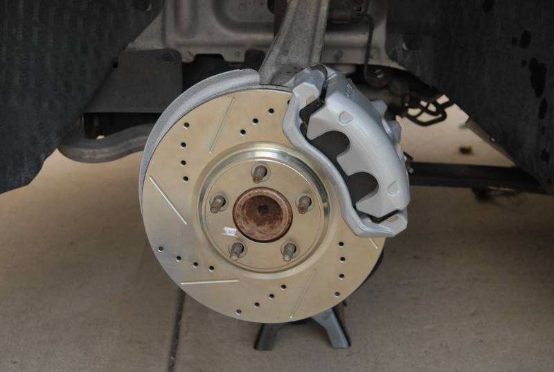

yes, i clearcoated everything
some people like to mask off the contact surface, but that prevents the clear coat from going into the holes / slots, where lots of rust tend to creep up
the only reason why i said to seal the whole thing then sand down the contact surface is to prevent pad contamination and the really heart wrenching sensation of braking on clear coat; really LOUD grinding noise and loss of stopping power, but that will only last for 1-2 days of constant braking, not something you want to experience trust me lol (edit: dont worry about getting ugly sand marks on your precious new rotors lol, braking will re-polish it)

gave it 2 light coats, then 2 medium coats and baked them for 1hr at 200degrees (stopped halfway cause the smell became unbearable and it gave me a migraine haha)
note: i just baked them to speed up the process cause i had to install them the same day (only day off), i actually followed the instructions on the label
if you do it make sure to spray several extra coats between the 2 disk sandwiches (lots of rust creeps up in there too due to no contact with the pads)

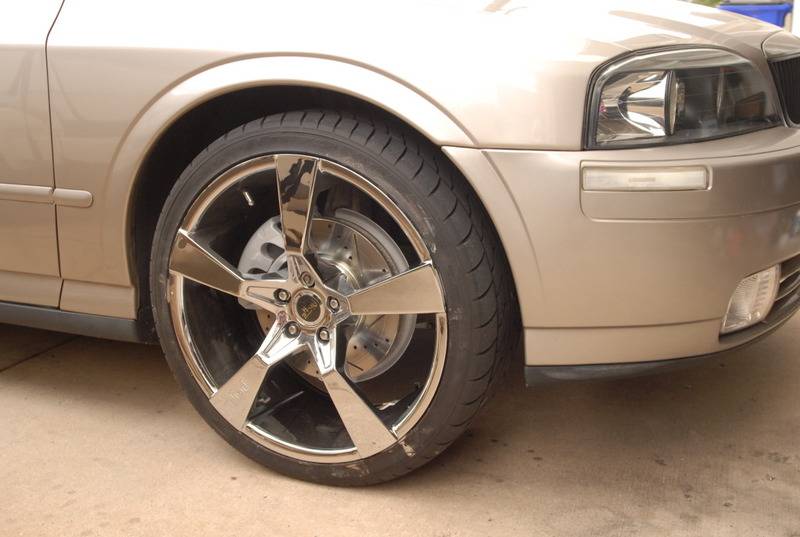

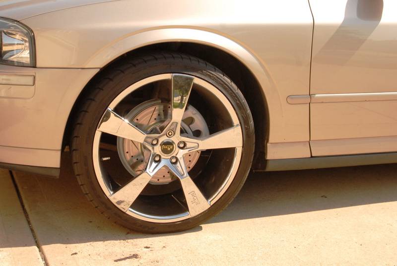

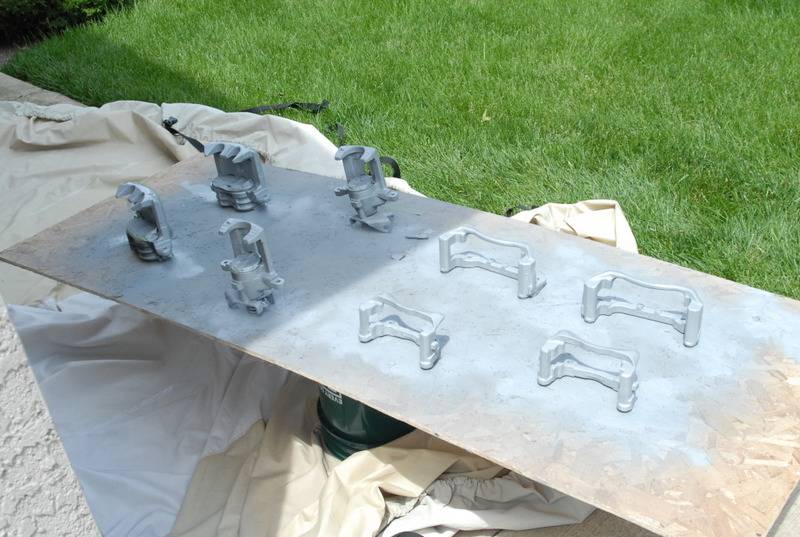

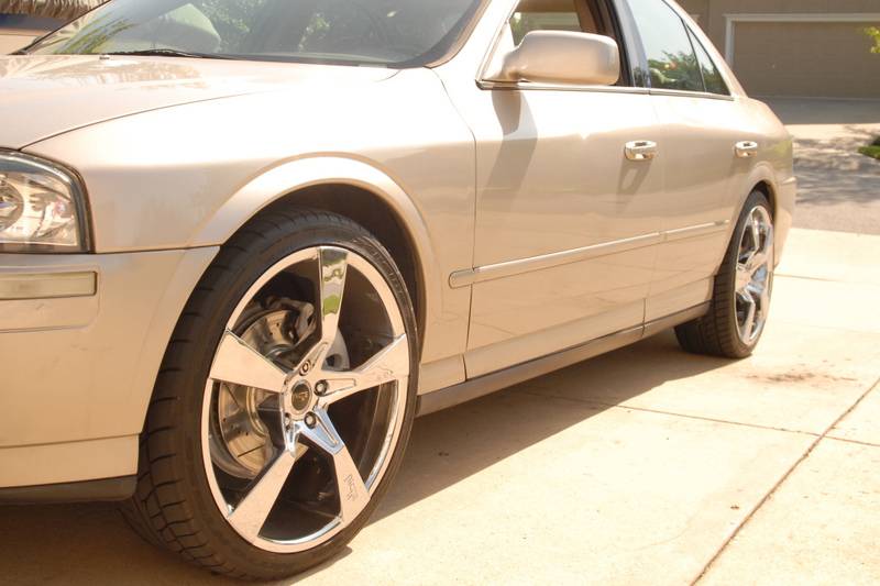

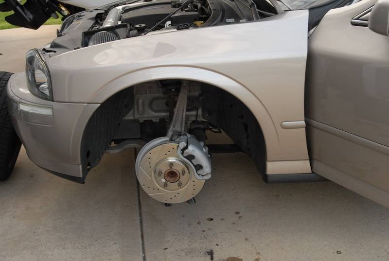

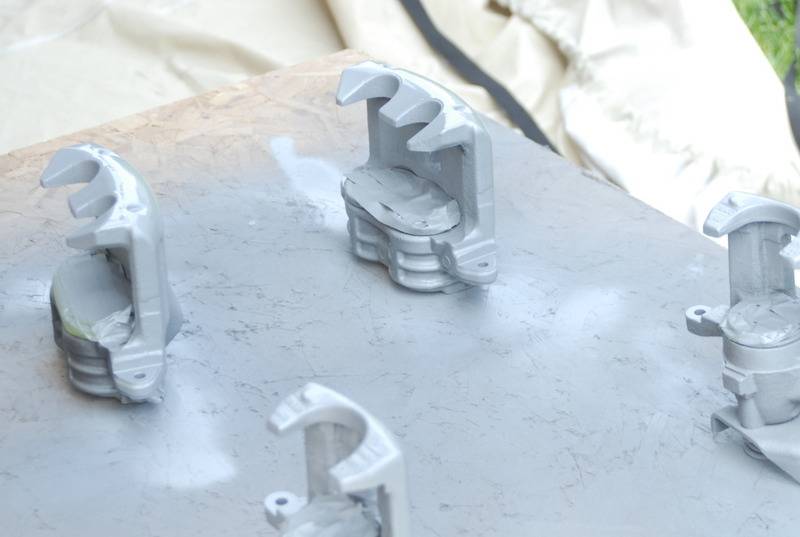

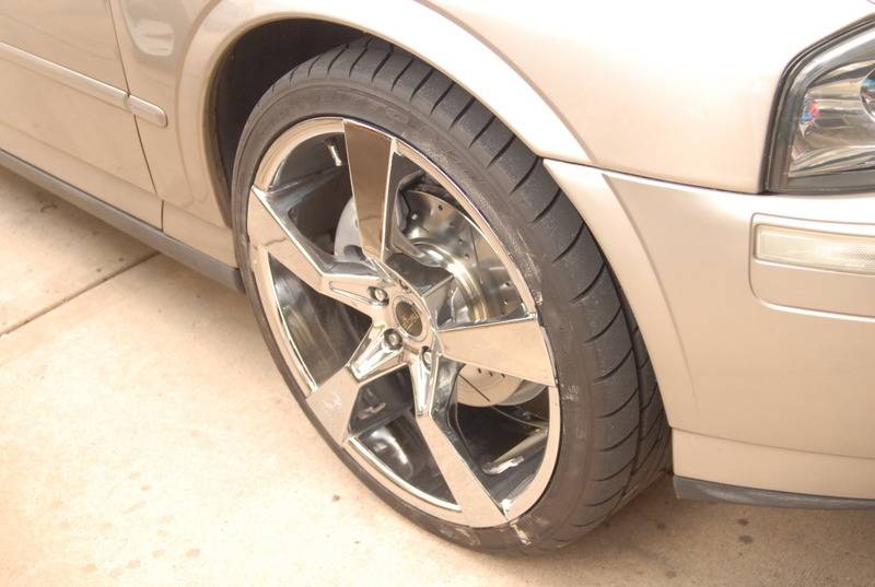

Knocked them out this weekend... Turned out well, I used VHT Flame proof/ header paint and Flame proof clear coat or the calipers. they turned out ok. they really "blued" up when the clear went on. More of a battleship grey now, but still turned out well. No noticeable braking difference, but they look great.. some quick shots from saturday and this morning....
leftover wax from storage on the tire
Great work! I was curious about the size as well. Also, you may be the only one to list their clubs in their sig.
20" (on stock springs, i know, i know...no need to say it)
Those wheels are pretty boss I like them. What kind are they? I don't put clubs in my sig because I'm using clubs from Walmart haha
Looks good Rell. And I am gonna say it.....do not lower it. LOL.
They are Niche Game 20x8.5 IIRC. I like them....LOL, clubs are clubs. its how you use them that count...
LOL, right on, I was going to bag it but... NM. :p
It needs to be lowered, just havent gotten around to it.. I'll do it when i do the front end kit like we talked about
I usually end up with passengers on road trips. Add luggage to that and I end up never lowering mine. LOL.
very nice job on the calipers! damn all those pics of slotted rotors making me regret not getting slotted too lol
did you end up clearcoating your rotors?
nice wheels btw kinda different but i dig
