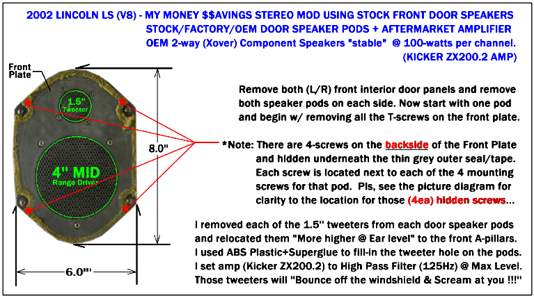

Here's my audio/stereo mod, using the stock 6''x8'' speaker pods that are located in each door. :) For those with a (somewhat) $$ Limited Budget $$ but have an aftermarket amp. (For this mod I used a KICKER ZX200.2 Amplifier 100watts x 2-chnnls.
My reason for this mod, (first and foremost) was because I couldn't decide on which brand/model aftermarket components to buy. So I decided to see how the stock speakers sounded w/ the KICKER AMP. So I took them apart to see what I had to work with and went from there. (2-way) Components, crossover partitioned.

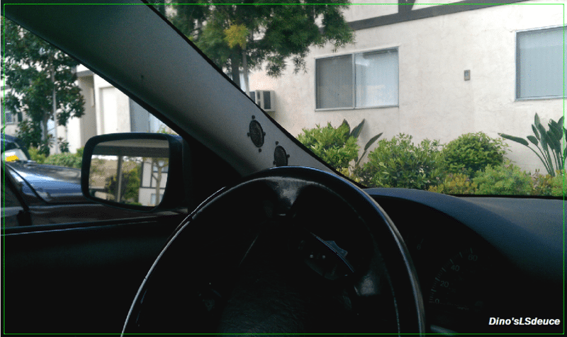

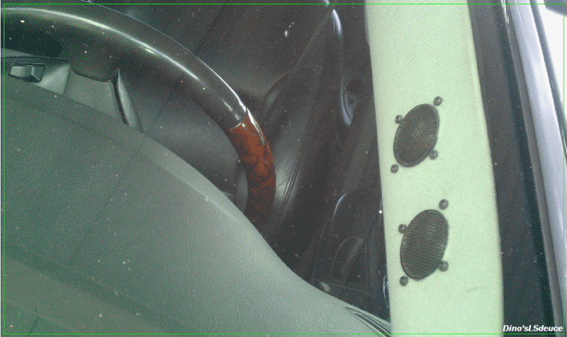

That's when I decided to relocated those tweeters into the A-pillar trim post. Here's some pics...For those of you who are interested; whilst reading this, but would like to see more ''detailed pics'' of how the Tweeters are mounted and/or how they look fitted/mounted from the back of the A-pillar :confused:. Let me know and I'll reply with more pics if anyone is interested... :).

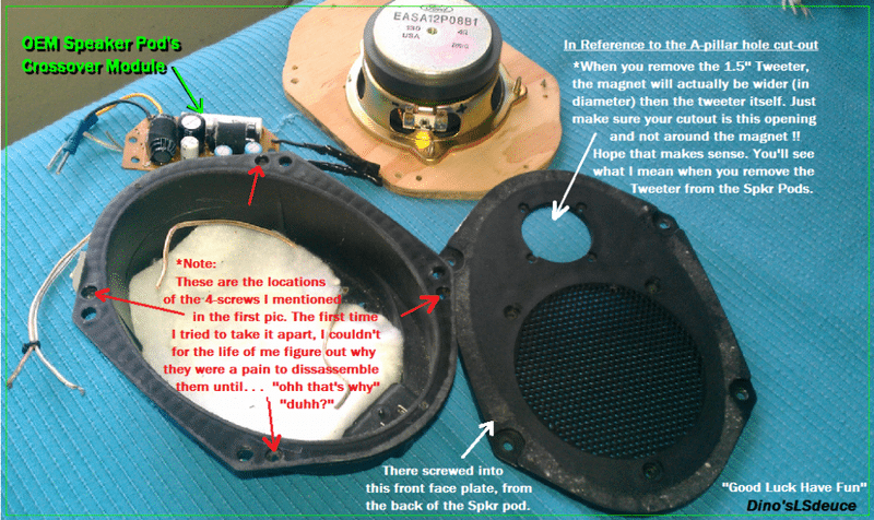

Speaker Pod disassembly Note
From the front...
From the inside...
Outside Close-up...
Speaker Pod Notes...
A-pillar Upholstery Note...

;) hite337/marcredd - Looks good but how does it sound? - Yeah it sounds pretty damn good. Marcredd, good comment/question, regarding the harshness of the tweeter location/freq. produced. Yes, at times with certain songs and certain frequencies, it does seem "harsh" almost like a "screaming piezo horn" but overall the advantages outweigh the OEM Location.

Starfire - for the 6x8 door pods how deep are they? - The depth is 2-1/8" for the pod. But the overall depth (including the front face thickness) is 2-5/8'' thick.

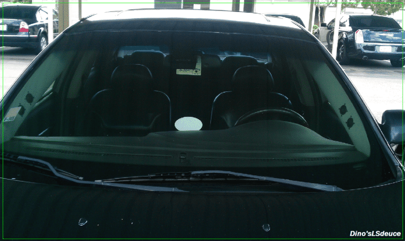

1) they are aiming at the glass: a lot of unnecessary re-verb from the hard surface, and they are aimed at each other.
2) I would have tried to clean up the install. no extra money, but not have the screws on the face. Unless you like that which is fine, my opinion is not to have them like such.

Nice work. If I were to change something, I would get some SEM paint to match those grills (at least the screws) to match the cloth color.

Comment #2) I would have tried to clean up the install,...but not have the screws on the face. Unless you like that which is fine...

Comment #2) ...Those screws (I believe and in my opinion) are actually necessary because they connect the top plate and the Voice-Coil to the Magnet of the tweeters assembly. I would hate for those coils to somehow rub up against the magnets wall > create a short and "shortening" the travel motion of the tweets voice-coil.
Question #1) ...That's a good question. My answer is, Not really. Working with a almost "non-existent" budget; I just put the tweeters as close to ear level as possible because of the OEM wattage I had to work with and not being a high-fidelty aftermarket component. As far as trying different angles; Unless I attempted to fiberglass and angle a ring-mount that would've been ideal, but since were talking about OEM tweeters in wasn't worth the extra effort. Also, unlike aftermarket tweeters, those OEM tweets fastening screws need to be "flush-mounted" flat due to the tweeters assembly (see Comment#2).

Comment#1) ...I would get some SEM paint to match those grills (at least the screws) to match the cloth color.
My Reply... :I
After looking at them, your right. I need some paint on those things.:D
