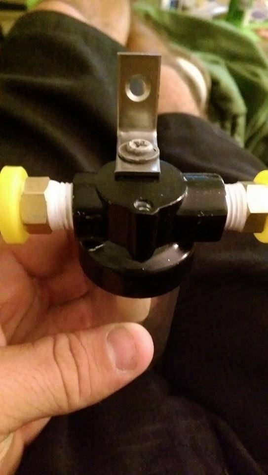

My AIR/OIL separator install on 1996 Mark

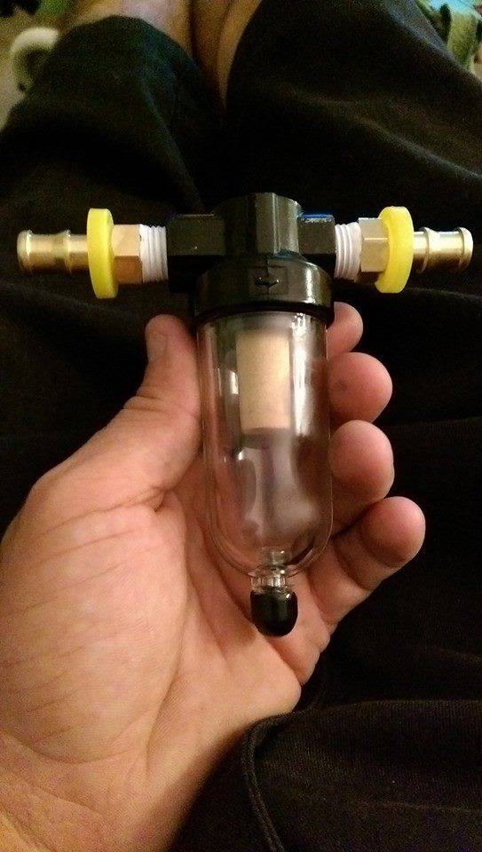

I'll look at the specs on the JEGS one. This one is rated at 90PSI which seems to be the average for most of the ones I'm looking at. When you step up to a little more expensive, I saw 150PSI a few times.
Appears to be the exact same thing, actually. 1/4 x 3/8 barb. It has a slightly higher maximum PSI though. The can height seems to be the same too (5").
http://www.amazon.com/JEGS-Performance-Products-52205-Separator/dp/B007WWW6DI
Designed for vehicles with positive crankcase ventilation systems, this air oil separator prevents oil blow-by from being displaced into the intake tract on engines where crankcase pressure is high, such as high RPM applications. When installing, always route separator away from heat sources. Highlights Maximum pressure 150 psi Clear polycarbonate bowl for easy viewing and durability Serviceable 5 micron element Twist/turn drain Mounting bracket included Two 1/4" NPT x 3/8" hose barb fittings included Easily cleaned with dish soap, a thorough rinse, and air dry only.

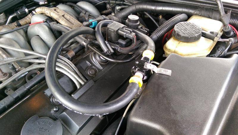

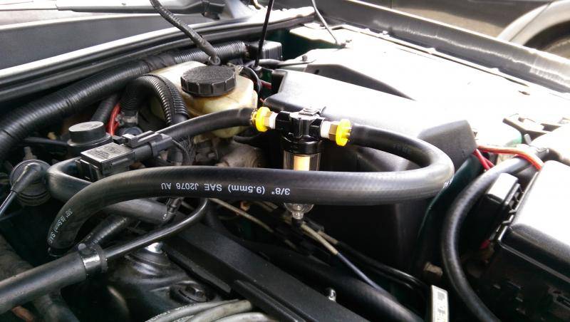

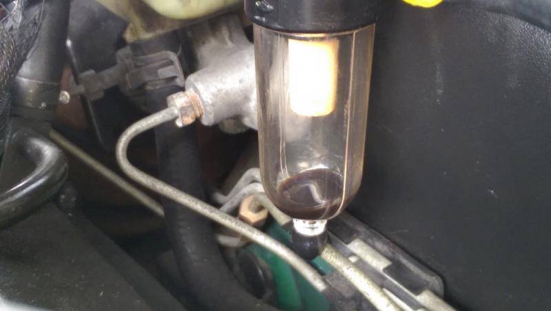

Also, I just finally looked at what I'd be doing.
Remove the F and run the hose from the PCV valve to the can. Second hose runs from the other nipple of the can to the line that the PCV valve elbow was originally connected to, correct? (the one that leads to the emission T in the back).

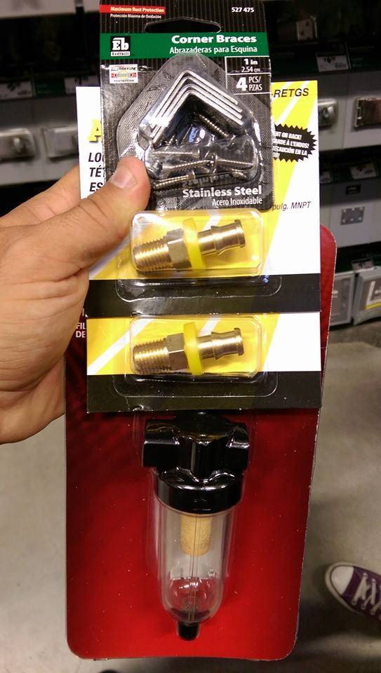

Alright, sorry to continue posting so much but just an update. I went to to Home Depot and checked out that first one I posted, and it was in fact rated for 150PSI max. The specs are identical to the JEGS one, except the JEGS one looks nicer. Possibly higher quality material, not sure, but this one is solid.
I bought everything and put it together. Price including all parts, bracket and 3 feet of hose was $28.xx. I'll hook it all up tomorrow and see how it goes.

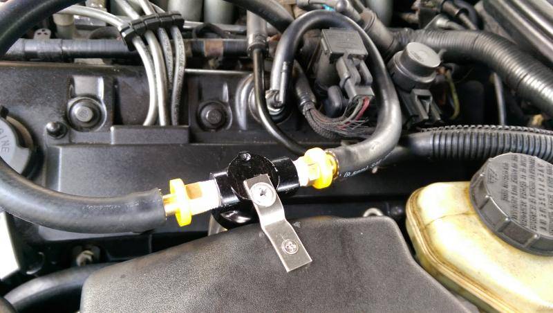

It's not the sexiest thing but it'll do. I don't know what I was thinking not using elbows instead of the straight nipples. That would have cleaned up the look quite a bit.
I'd recommend putting a motorcraft pcv valve in there. Also is the top F open to atmosphere? If so you want to plug that off
No no, it's plugged. It came with a little plug.
I changed the PCV about a month ago, just because I wasn't sure when the last time it was changed. I plan on buying a Motorcraft off eBay. It's about $8 or $9. These cheap ones, you can't remove that "F". I tried before I finally decided to just attach it like that.
I wish it looked more factory, like yours. If I get some brass elbows, I can clean it up. I work for a propane company so I'll see if I have 1/4 x 3/8 elbows at the shop, since I have a huge variety of brass fittings there.
