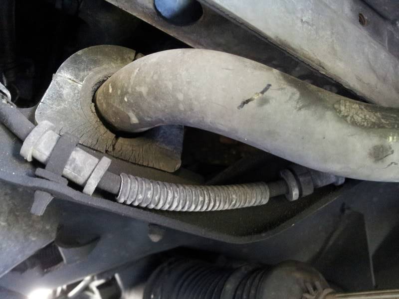

Ok boys, I went underneath the car & snapped a few pics. A bit tight since the car is lowered but enough for you guys to take a closer look. Let me know what you guys think.
Sway bar bushings can still take a bit of a beating. Yes they are worn but you can clearly tell that the rubber is still there, so no clanking can be coming from here.

For a quick test of the sway bar links, turn the wheel all the way, hold the link with your fingers, and have a friend bounce just that corner of the car. You should feel it clunk if it's bad.
Those sway bar bushings are very shot.:)
:eek::confused::p
You're wrong, your sway bar bushings are junk, replace them.
:eek::confused::p
+1, bushings are TRASHED, you can clearly see its split thru the bottom, look at all the wobble room around it. And the link boot looks flat like no more grease..replace both

Replace those sway bar bushings. They are cheap and it can only help.
