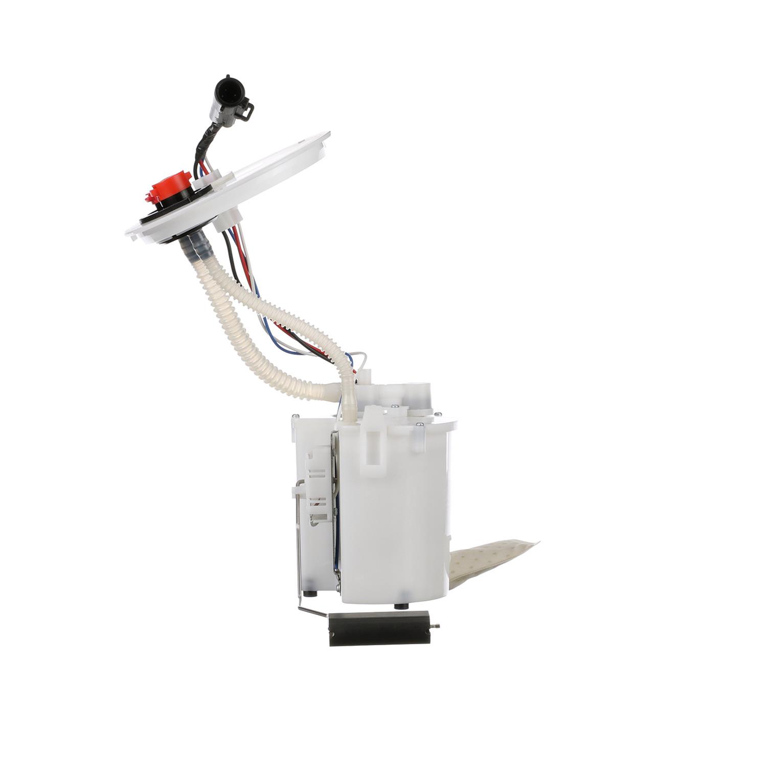

My suspicion of the pump , given its age and the fact that my Silverado had the exact same symptom , also given its age. I don't know what in the ign. system would prevent the engine firing given its coil on plug and CPS design.....anyway , after reading where Joe and one other owner smacked the pump to rattle the motor off its "dead spot", I'll be damned if that didn't get it spinning again. The pump sound is "faint" but yes you can here it momentarily before ignition. I didn't think to listen when it wouldn't fire initially , but trying again later I didn"t hear it. So after the "wack" I heard it and it fired. I'll replace the pump relay and get another pump , at least a motor anyway ( not Autozone or Advance ) but not Ford either. I have to buy the tool to remove the ring because I'm afraid given the age of all the connectors / retaining rings something might break.

I had put a delphi fuel pump in my blazer and I drove it for 3 years with no issues then I sold it.. the assembly I dont know but it should be good if the fitment is ok
I had , like an idiot , forgotten to install the new gasket on the pump top before connecting the lines. On the Delphi pump the plastic elbows WILL NOT just release their grip from the sockets on the top....even when squeezing the tabs....I had a hard time installing the larger one just getting it to seat I had to tap it with a small hammer while squeezing. Now that I needed to remove the pump to replaced the gasket I broke the plastic elbow.

The problem is , Delphi has made the connection ports slightly smaller than Ford did....so when you install the elbows they are so tight ( in fact they had to be forced in by tapping with a hammer , not THAT hard , just enough to seat the elbow ) you KNOW its going to be damn near impossible to remove them......in fact , I'm here to confirm , you WONT. All I wanted to do was remove the lines just like I did from the original , lift the pump back out and install gasket and re-install the pump. No f'n chance....thanks to the made in China pump. It also didnt fit in the well like its supposed to. More and more its looking like time to get rid of the LS , I hate that , but this may "break the camels back".

Go with a Spectra Fuel Pump assembly...never never never ever buy Delphi or Dorman ...straight garbage
