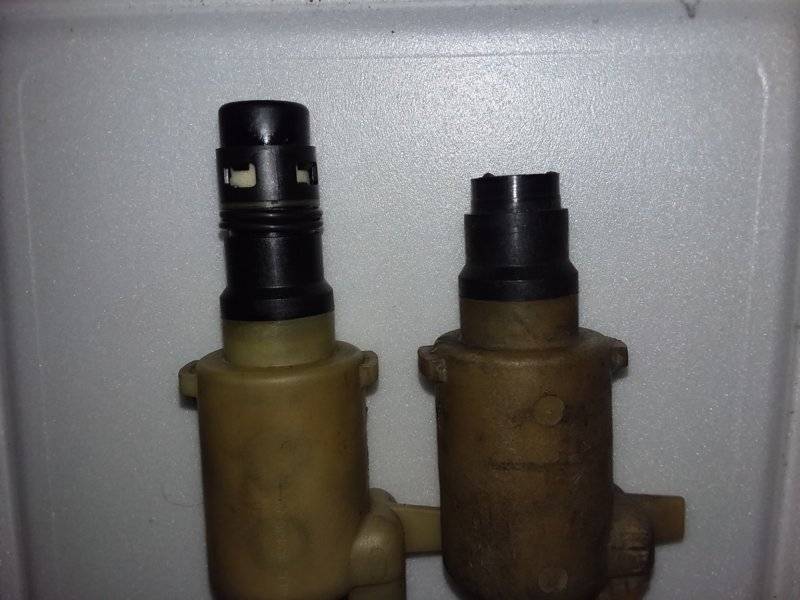

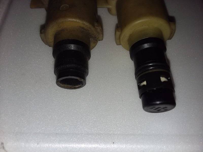

    You might have a leak in the air ride. Spray some soapy water on top of the air spring, diaphragm, or the air lines while keeping an eye out for bubbling. Also, check the solenoid valve that's inserted into the air-spring.
    One of my other Marks(BA) used to behave the exact same way while maintaining ride-height but would struggle to pick itself up after highway speeds. I could hear a "hiss" every now & then from the front driver's side and would sometimes find the front of the Mark a bit lower than usual or fully slammed after being parked for long periods.
    So, I ended up getting a WESTAR replacement air-spring. When I removed the solenoid from the failing air-spring I noticed the top black cap(where the air vents from) had broken and was stuck inside the solenoid cavity.
    Both solenoids in the pictures are from FORD.

    The solenoid valves are mounted at the top of the air springs, hang off to the side, and are relatively easy to access once you move height sensor & the solenoid locking clip out of the way.
    As for checking them,.... It's best to put the vehicle on a lift, jack stand it, and remove the tire. The last thing you want is for the front end to slam down and then you're stuck trying to find a pallet-jack or low-profile car-jack to get underneath a slammed Mark. Or worse, the front end of a 2-ton vehicle trapping & crushing your arm between the wheel well and tire as the car lowers from finagling the solenoid.
    However, the air springs do deflate a tad bit when parked to engage Park Height. So, perhaps the valve is sticking open slightly but just enough to let air seep out which leaves your Mark slammed after a few months of no power. Also, the diaphragm can be compromised from the car not being moved for so long as the rubber could harden and crack when it flexes to give lift.
