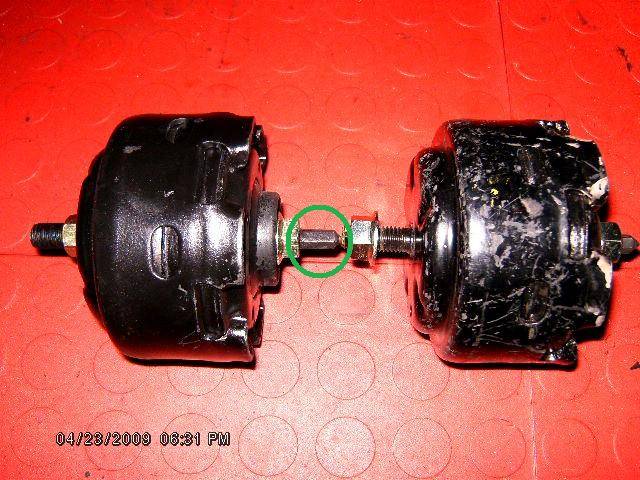

Anyone ever change the motor mounts and then have 1 side's cross bolt holes on the bracket not line up vertically with the k-memeber holes. It is about a 1/2 hole high?
Trim the mount stud. :cool:
Thanks for the hint. I had this bastard all back together and this was the last bolt to put in. I just got done redropping the K-member although it did not take long. Had some lunch and was going to get back on it a little latter to figure it out.
dlf beat me, i had to do that when i put ripped duche bags motor back in, i put brand new motor mounts on and had to trim the bolt too, i couldnt get the long bolt back through the k-member, trimmed that bolt and fell right into place!
