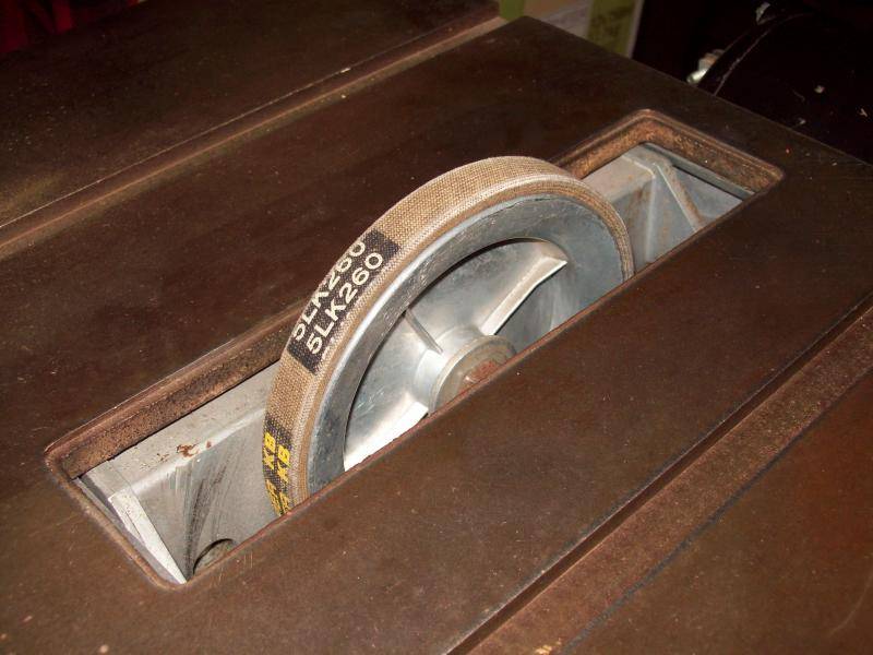

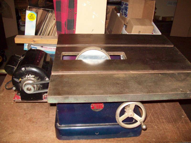

Rotor spinner.jpgpulley.jpgOver here in crappy CT they spray the roads before it snows, and this crap they put down will rot your car away. I have a pick up for winter use, a 1 ton 4X4 with 20K on it. Truck is like new. This year my rotors got all glazed and black. I got some Thermo-quiets on the bench waiting. I put this machine together with some stuff I had laying around. I call it ROTOR SPINNER. If I can spin the rotor on the car, and clean it, it will be a labor saver. Works on the bench, hope it works on the car/truck. TONYyyy
