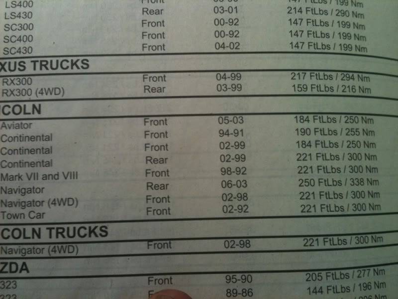

Book doesn't show rear spec, computer says it's 251Ft Lbs
