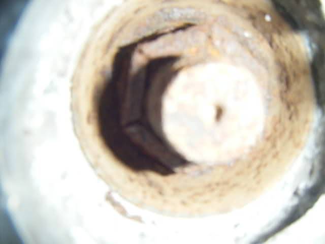

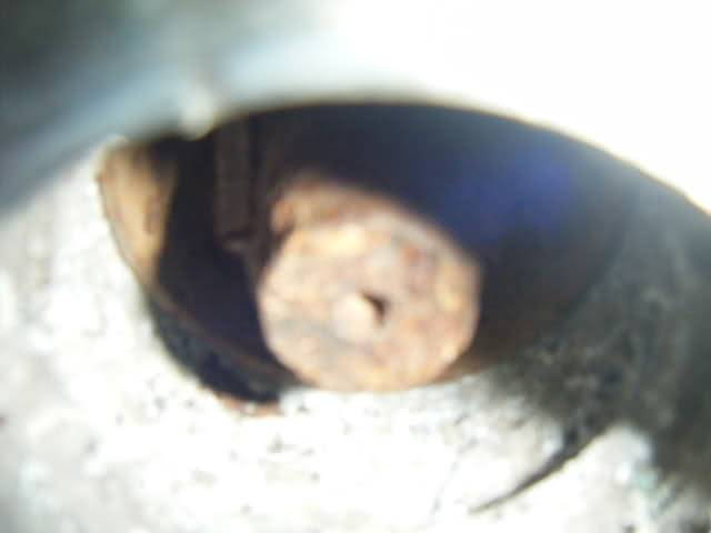

ok, i took the rear tire off recently and noticed the metal shaft(halfshaft?) that protrudes through the center of the hub/rotor is completely rusted..No sign of threads. ITS BAD..
So i'm sitting here bored and was wondering if my bearings go bad will i need to get used non rusted shafts so i can replace the bearings.If so what kind of work does replacing the shaft require?

I can't immagine why you couldn't see the hub nut threads on the axle, take some pics. You don't have to replace the axle when you swap in new hubs / unless the hubs have a different spline count, which they shouldn't. Axles will normally outlast the CV boots, when your boots bust open and sling grease everywhere, replace the axle
forgive the crappy pics
I believe he is saying his are completly rusted out. Someone else on here just had that problem where the nut and axle threads were rusted off and there was also rust dammage to the hub. The Mark tends to have rust issues there in bad climates.
that is "normal" up here above the rust belt. that nut is stock. and the solution usually is zip it off with an impact, the threads are there just filled with rust. but it wouldn't hurt to have spare shafts around if this is your only mode of transportation
Thats good to hear i guess..My friend said he could get them off w/ his impact but i was skeptical seeing as how theres no threads showing. I'll prob get a spare before i let him loosen them incase something happens..thanks chicken.
If you can get a socket on the hex you may be able to get the nut off. I just delt with this same scenario. Mine were WAY worse. There are other ways ot get it off. Try to do it without destroying the hub. Unless you are planning a mustang hub swap. You will have ot replace the half shfts.....most likely.
Don't worry about not seeing threds. There are threads where the nut is. It will just twist as long as you can get the socket on. The nut may disintegrate. Then you can just grind at with a die grinder.
