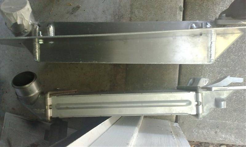

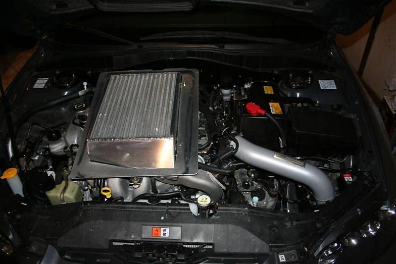

I know its not up to Lincoln status, but with a cheaper car payment and way more power I couldnt pass. At 32 years old, I couldnt get a STI or EVO with 2 kids, hehe. Its nice to run a 12.9 sec 1/4 and still get 30MPG on the highway :) A couple updated pics after Eibach lowering springs, new front grill, bigger 3.5" thick intercooler, CAI, downpipe, no cats, COBB Stage 2 custom tuned, new blow off valve, 3" turbo inlet tube, stage 2 kevlar clutch, DISI high pressure fuel pump upgrade.

Would you see any benefit to getting a FMIC over the TMIC?
A FMIC would be better but TONS of work to get it off and switch to stock when it has to go in for service. This ETS TMIC only loses 1.5PSI and is EXTREMELY efficient with cooling. The stock TMIC lost 4-5PSI, VERY inefficient. So Im in the middle between a stock TMIC and aftermarket FMIC.
