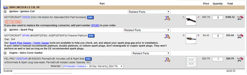

not to highjack, but joe can you confirm that this is what i need to do my coil/plug job?
Yes the DG529's OEM coils and the gaskets are the correct ones. VCG's only needed if oil in the plug wells is discovered.
I'd get the NGK Iridium plugs instead.
