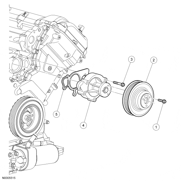

I was going to say water pump but in the 2006 Lincoln LS Shop manual they subject it under the Title " Coolant Pump "
Coolant Pump
Printable View (148 KB)
Item Part Number Description
1 W705629 Coolant pump pulley bolt (3 required)
2 8509 Coolant pump pulley
3 W500304 Coolant pump bolt (5 required)
4 8501 Coolant pump
5 8507 Coolant pump gasket
Removal and Installation
  1. Drain the cooling system. For additional information, refer to Cooling System Draining, Filling and Bleeding in this section.
  1. Remove the thermostat housing. For additional information, refer to Thermostat Housing in this section.
  1. Loosen the coolant pump pulley bolts.
    • Do not remove at this time.
  1. Remove the accessory drive belt. For additional information, refer to Section 303-05 .
  1. Remove the 3 bolts and the coolant pump pulley.
    • To install, tighten to 10 Nm (89 lb-in), then rotate an additional 45 degrees.
  1. Remove the 5 bolts and the coolant pump.
    • Remove and discard the coolant pump gasket.
    • To install, tighten to 8 Nm (71 lb-in), then rotate an additional 90 degrees.
  1. To install, reverse the removal procedure.
    • Install a new coolant pump gasket.
  1. Fill and bleed the cooling system. For additional information, refer to Cooling System Draining, Filling and Bleeding in this section
