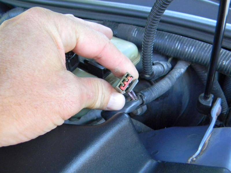

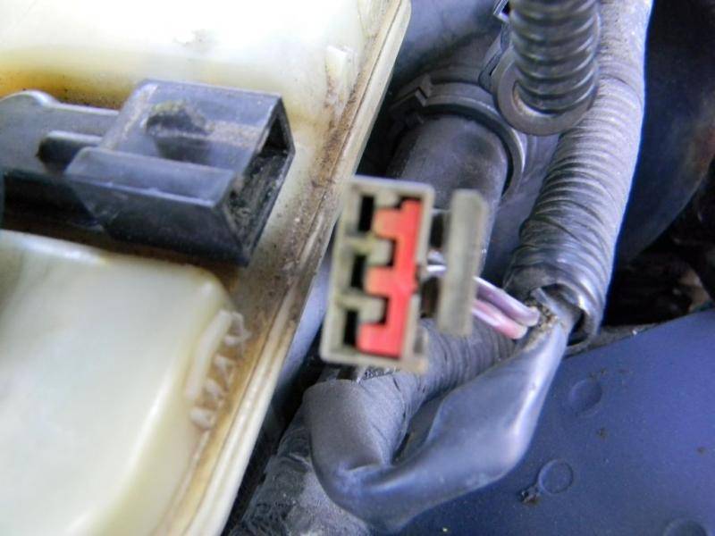

Then remove the wire harness plug from the MC bottle and loop the circuit with a small piece of wire.. ill load a pic
Brake light does come on when the e-brake is pressed, but not when you turn the key on. The wire harness that plugs into top of MC is corroded to the point that it's not making connection. Is this plug for the brake light on dash?
The plug on the MC will trigger the same light as the Parking Brake, if you unplug that and then loop those connectors, the light will come on-or should.
