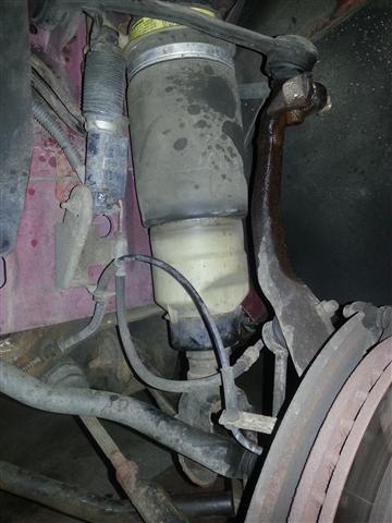

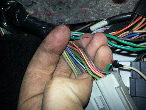

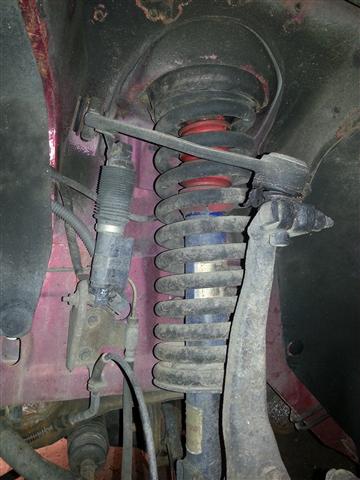

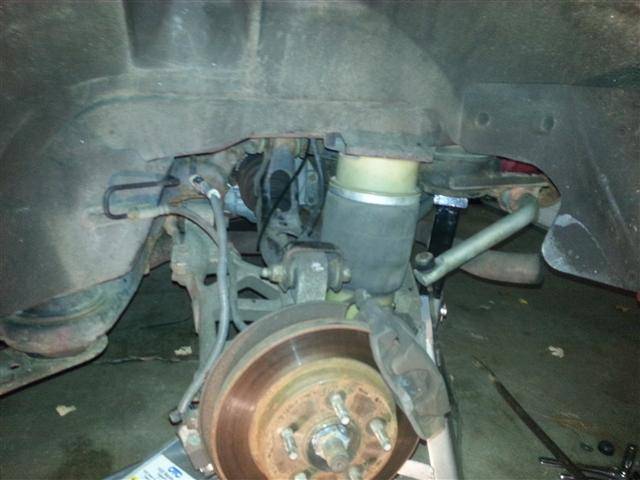

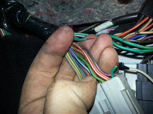

I think it took us (3 guys) 5 hours with drinking, bs'ing and messing around with other stuff. Should only take 2 hours especially since you don't have rust. I did have to re-solder my wire that told the computer to "check Air Ride" but other then that it was easy. I still had my Air compressor and air lines in, even though one was cut a bit too short.

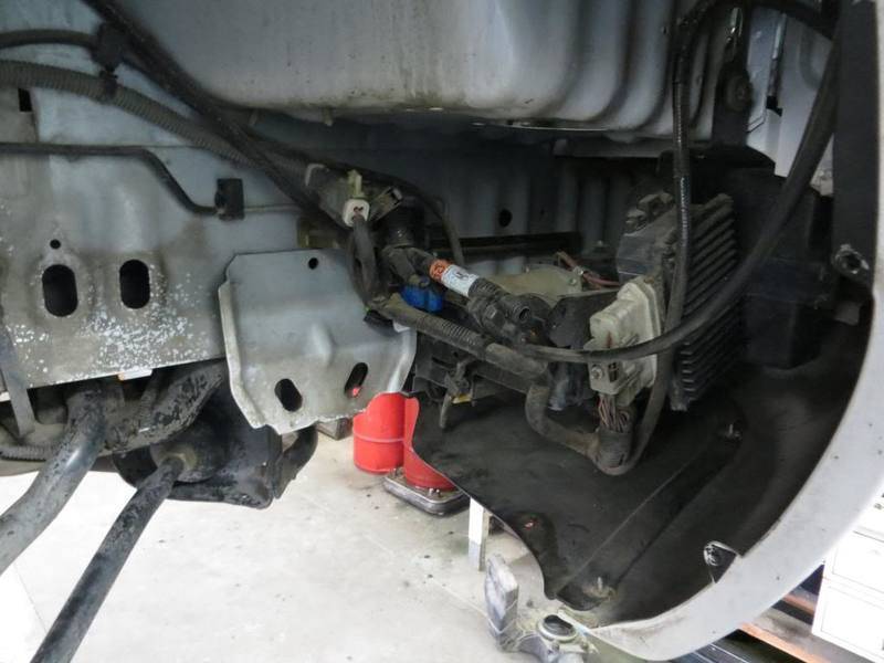

Strange question - I can't seem to figure out what the module to the right of my compressor is.
