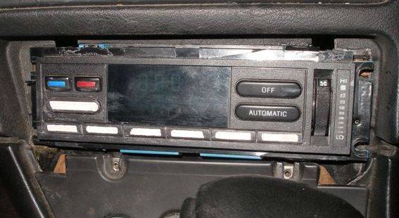

I did a little work in the interior last night. My heater control had all but two of the buttons cracked. I figured I could either buy another one which is porbably cracked or try and fix this one. If I didn"t work out at least I tried.
What I did was fill up the buttons with bondo and then sand them smooth. I plugged it back in and everything works so I'm gonna paint the buttons and see if it lasts.

I thought about how some would glow and others wouldn't. All of them are going to be the same so at leasts its uniform, the other things is that it says what mode the heaters in so I won't have to worry about forgeting what button does what.

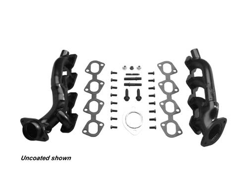

So what are all the options for manifolds or heasers for Marks?
So far the option I've found are stock, cobra, aviator, or kooks. Are there any other choices? Kooks are nice but I can't justify spending that much on headers, at least not right now.
Headers are a waste in almost any application used - unless you doing serious mods that can justify them.
But the problem is the manifolds. The passenger side is a true manifold, not attached to the cat. The driver's side is and as such is unique and made for the Mark only.
If you put any other manifold on there you may have to modify the steering shaft. My Aviator engine manifolds totally blocked the steering shaft and no matter how I modified it, it would not fit. So I moved onto Cobra manifolds. Much better fit, but still had to make a custom steering shaft setup.
Another user I know of put stock Cobras on his stock VIII engine, had the same problem as me.
We had both used 03/04 Cobra manifolds - I dont know if earlier years would have the same problems or not.

Kooks makes a nice set of headers for the Mark VIII. Only problem is, the only way to get them is to go through super Coupe Performance, since Bill Evanoff has exclusive selling rights to those particular headers. The asswipe...
I can get some manifolds from a 97 Cobra for free. I hope they would work without to much of a hassle. The stock exaust just seams like it couldn't be more restrictive.
If I'm luck I might be getting the intake manifold for free too.
What makes the 4v exauhst ports different from the 2v, I've seen gaskets that say they are for eitehr the 2 or 4 valve engines? If the ports were the same couldn't you use any manifolds for any modular?
Correct me if im wrong guys, but I dont think the cobra manifolds will work.
I think the only set that will actually work is the kooks which go for about
600+ bucks from www.scp.com

I just need to do something because the stock cats are bad and that means replacing one of the manifolds anyways. I plan on putting on all new exaust while I'm at it.
What exactly makes bbk's headers not fit?
Are kooks a direct bolt in without any modifications to the car?
The Kooks headers are a direct bolt-on, but you will have to replace the valve stems on the tires.

to answer your question, i believe they are a direct replacement, but you will need new cats, and you will need to lengthen your 02 sensors so that they will fit.
The kooks headers come all the way to the bottom of the car so your cats will be mounted under the body somewhere.:)
or so i think, ive never done this before just heard
If I went the big bucks $$$ route of doing kooks I would do a completely new exaust, LMS twin x pipe stainless mandrell bends no muffs and nice polishesd tips. The only problem is that I would be looking at upwars of $2000 for all of that.
I'm just trying to figure out how to do an exaust system for a decent price. I want to redo everything from the manifolds to the tips. Even doing everything myself it is pretty dang spendy.

Oh, and if you go with headers and such you may need a customer steering shaft depending on what you go with. Generally not if they are made specifically for the Mark. If they are made for Cobra and such, set aside $200 for a custom shaft setup - you will see when you get to the end of the project if you will need the parts :) My 04 Cobra manifolds required a custom shaft....was pissed.
