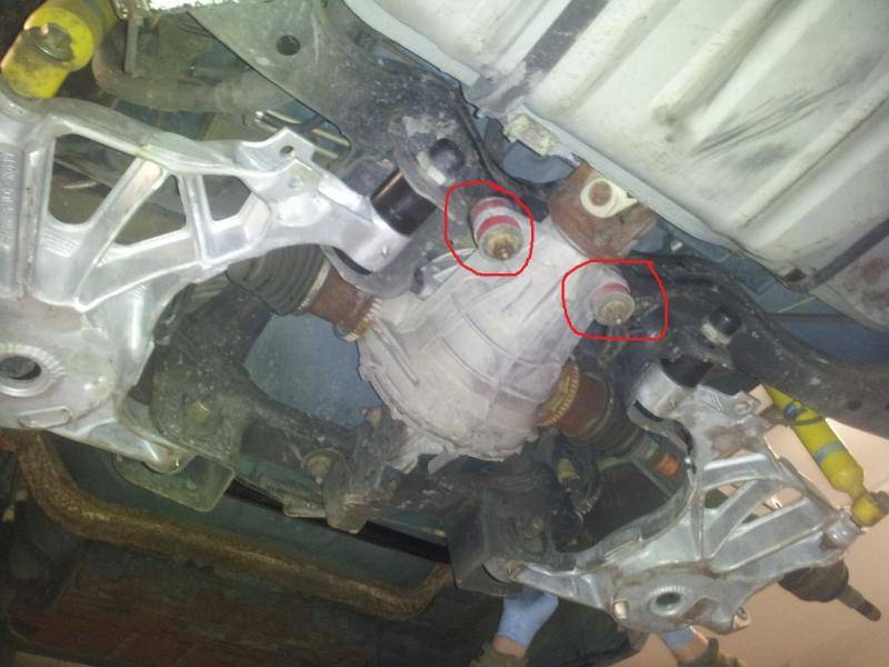

there are 3 diff bushings. 2 bolt through the diff on either side of the pinion tube. you can replace these bushings and that should fix the problem.
i removed the bushings and shortened the metal sleeve to increase the preload. worked fine.
there is also a big one in the back. but mine looks alright at 200k, so idk if its a problem.
If you ever saw the amount a leaf spring cars rear moves up and down you would freak compared to the 1/4 inch yours is moving. But like chris said you can shorten tube in front ones or buy poly bushings. Stiffer.
i think i spoke wrong, i meant it is rotating, the whole chunk, as in changing pinion/driveshaft angle under load...

Sounds like you just need new front bushings.
