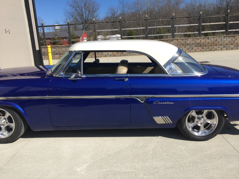

I have a 1998 Mark VIII, 5.4 L DOHV engine in a 1954 Ford Victoria. The Mark VIIIs did not have a tach and I want to add one to the installation in the 1954 Ford conversion. There is no tach feed wire coming from the Mark VII original PCM being used. This PLC is likely used in other cars with similar engine/transmission setups, some of which had tachometers. It has 104 pins, of which 78 are used in the 98 Mark VIII setup. Someone smarter than me, advised that he had info indicating that pin 48 would be for a tach signal in an installation with a tach. So, I got a wire and pin into position 48. That didn't give me a signal. Where do I go from here ?

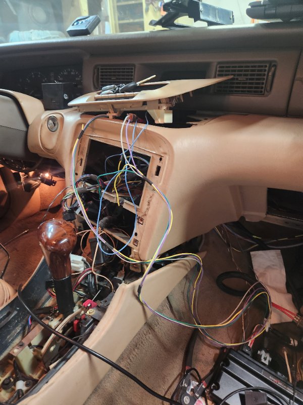

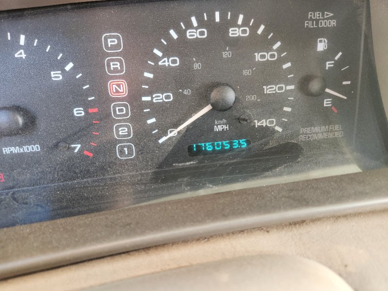

The mark viii does have a tach
And with my holley I get the tach from the crank shaft position sensor
If you say 'the crank case position sensor is the place to get a signal to feed a tach', Ill try that. I .appreciate your input. Will be a week or so before I have an opportunity to get into this. PS, The Mark VIIIs did not have a tach.
All Mark VIIIs had a tachometer.

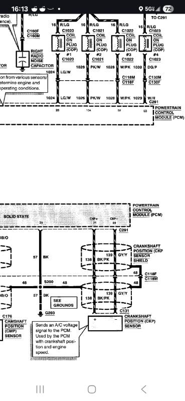

Back to this issue of putting a Tach in my 1954 Ford having a 1998 Mark VIII engine, transmission, computer (PCM) and a few other items but not a lot of the wiring and instruments. After comments several a few days ago and going over 1998 Mark VIII Electrical & Vacuum Troubleshooting Manuel, I think I should get the signal Crankshaft Position Sensor (-) which would be Pin 22 of the PCM.
The crankshaft position sensor output is an AC signal to the PCM which I believe is approximately 1 volt or less in amplitude. I think most tachometers signals are a 0-5 volt square wave.
I'm not sure what the result would be tapping only 1/2 the AC signal from the crankshaft position sensor? I guess it ultimately would depend what tach input is expected. You may need to modify the signal.
