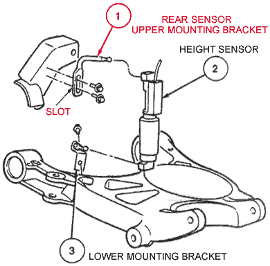

If only one end is higher, then I'd check the rear height sensor. Perhaps it got stuck or moved out of place when the rear bags were installed.
Unlike the front air ride which has individual height sensors for both Left & Right wheel, the rear only has 1 sensor that works both sides, it's behind the rear driver side tire.
How to Lower the Lincoln Mark VIII Suspension Sensor
If the bracket moves up, the system thinks it's too high and lowers the rear.
If the bracket move down, the system thinks it's too low and raises the rear.
