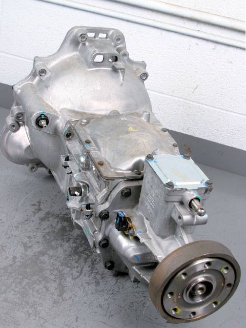

Your comments about the weight considerations are well taken and that is why I have considered at least going from the 3.27:1 first gear to the 2.95:1 in my T5.
