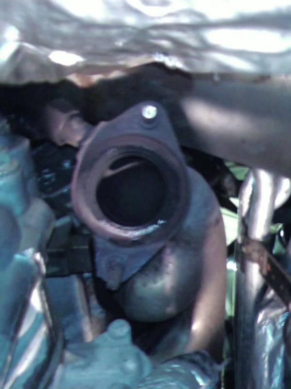

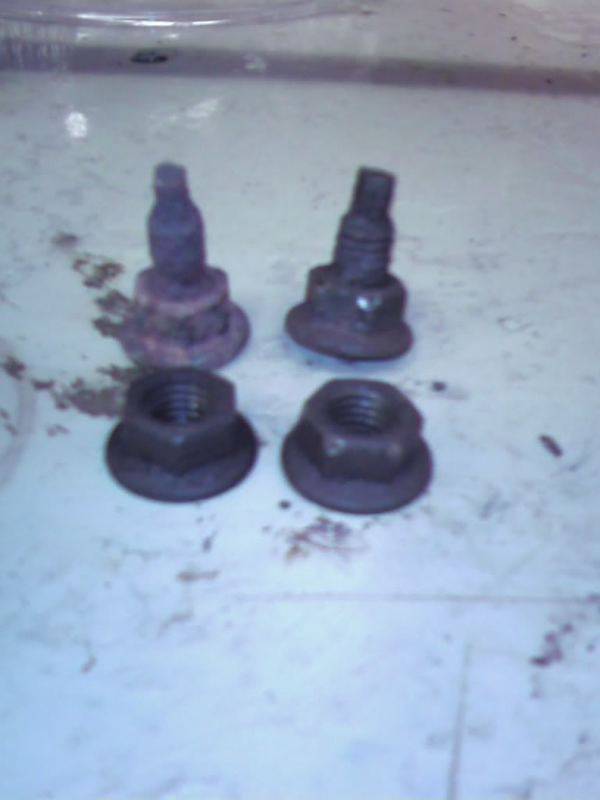

Here's some pics of my crappy experience..
BOLTS.. TWO UN-BROKE FROM DRIVERS OTHERS FROM PASS.
PASS. SIDE MANIFOLD
My teacher still wants to take that off.. I am going to try everything in my power to get them off w/o taking that off.. He's bringing in a stud extractor in Monday so we'll see how that works out.. If not, I think I can get a grinder in there to cut them off flush to drill them out.. Main thing is, they're out..
Don't you have torches in class? Those would have not broken and came off like budda if you torched them cherry red. That would have saved all this trouble and been done in minutes. My rule of thumb is always torch exh nuts no matter what.
Oh PS if those are cast manifolds(like my V6) you will have to torch them to get broken studs out. Mine where a bear even with heat and working them on the ground.
Also they make exh "C" clamps that are made to clamp exh back onto manifold. I have used these on a chevy and they worked 100%.
I used a crap ton of PBBlaster and heat.. We heated them up cherry red today and used a stud extractor (bit to big for the job) and it still wouldn't come out.. Also used the shock method (heat and cold water).. Like I said, he's bringing some tools in on Monday so I guess I'll see what he brings in and if it helps.. If not, I'm drilling them out..
FYI If heating till cherry red no need for PB blaster cuz it all gets burnt off anyway and nothing beats heat.
I sprayed PBBlaster after the day was done so that it would soak in and maybe eat away some of the rust. Then the next day try heat and it still wouldn't come out..
