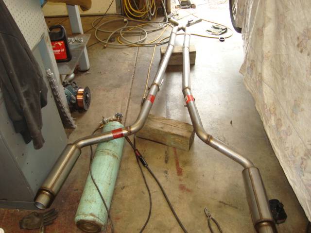

I chose Pype's 409 SS Race Pro mufflers and hand fabbed a 2.25" X pipe and 2.5" SS pipe the rest of the way.
05 Lincoln LS, new exhaust - YouTube
After a couple weeks the tone has gotten deeper and I can hear it slightly over the wind noise at speed but it still doesn't attract too much attention.

I know :confused: It is louder now that it's been run for a couple weeks. I'll have to try and get a better video of it. Pretty wild since other than the cat's it's a open pipe. I should have done it in 2.25 all the way back as I get no flow at idle, just some heat out the pipes.
what model # are the mufflers, i know some places sell just the mufflers very cheap, i can have all the bends made and all that jazz not wanting to pay $800 for a pretty exhaust that ill never see unless im changing my oil
This is four 2.5" J bends, 10' of 2.5" pipe, two Pype's Race Pro mufflers and one 2.25" J bend that I turned into an 'X' pipe. 409 ss everything for around $350 in materials.
The 3.9l uses 2.25" pipe after the cats so I just used a pair of butt connection band clamps to couple my cat-back to the cat pipes. Other than a bandsaw and belt sander to cut / fit the cut ends it took some extra jackstands and plenty of patience.
