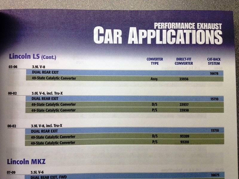

They offer two systems, part #15710 for the Gen I cars that is a 2.25" system and part #16678 for the Gen II cars that is a 2.5" system.
Currently the Gen I system is listed for both V6 & V8 applications, however they only list the Gen II system as fitting the V6 car and I'm not sure why as they used to list this kit (#16678) as fitting both V6 & V8 cars.
Maybe they made a change to the Gen II kit, maybe not. It could just be that the V8 application was mistakenly omitted during a website update.

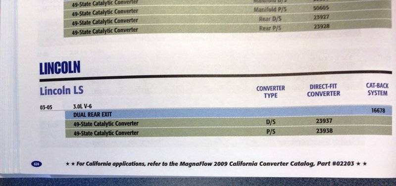

Here are the LS listings from their 2010 paper catalog.
BCA, your post doesn't seem to show pipe diameter, so far as I can see. I put a cat-back system on my '02 in '07 and although I didn't measure it when I installed it, I believe it was (is) 2.5 inches in OD. Can you provide enlightenment?

Those are pipe diameters that are currently listed for each kit on the Magnaflow website.
