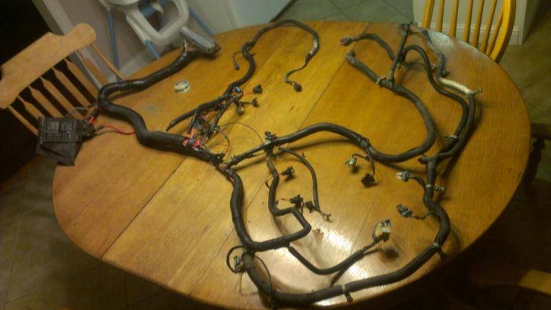

Got all the parts I ordered in the last few days. Got the harness all wired with the new fuse box, injector plugs and rigged for stand-alone. Chopped the mid-section out of the engine crossmember and the GTO pan fit like a dream. Need to brace it up a bit before I start driving it. I worked til late last night and all day today on trying to get everything back together and get the motor fired but ran into a few problems which will set me back a day or two. Got fuel leaking from the new filter/regulator so I'll have to return that one. Gotta pick up some battery cable because the factory engine ground and alternator wire wont reach. Gonna try to pick up a driveshaft tomorrow too gotta be around ~58 inch center-to-center. Any luck it'll run by the end of the week.

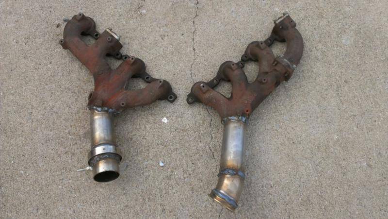

Sorry for the lack of updates recently, been busy with finals coming up in the next few weeks. Its not driving just yet but I have got the exhaust manifolds finished up with the v-bands installed. The shifter cable and brackets are done. Only problem with that is the stock shifer only accommodates 5 actual shifter postitions (P,R,N,D5,D4) and bump-shift which is electronic and I need 6 actual positions (P,R,N,3,2,1) to have full control over the transmission. Gonna live with it for now, might try to find a non-sport shifter later since it has more gears positions I think. But anyways its that's done. Waiting on a pinion flange to come in to mate the cobra stump to the crown vic driveshaft. Gonna try to get the coolant hoses for it today and finish plumbing the transmission cooler.
