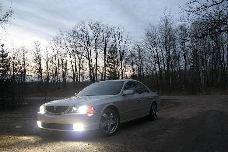

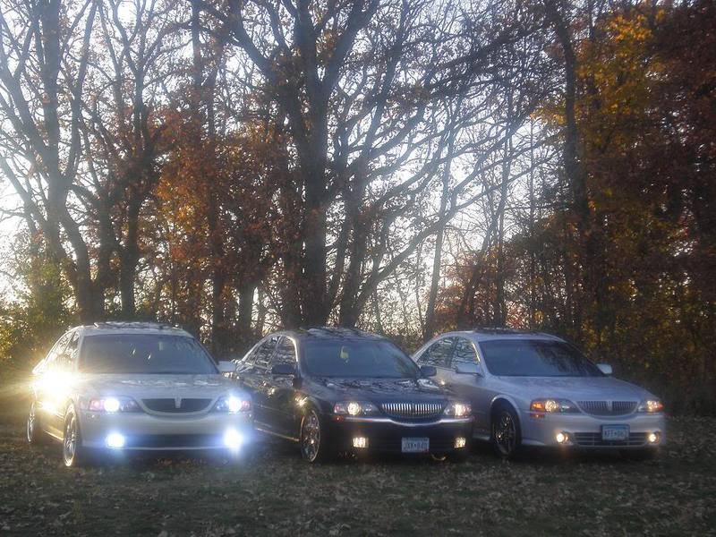

Old pic. Same lights as I have now, but just taken with a crappy camera. 6000K in lows and fogs:
Hey Pete, that second pic with the trees is awesome. Pic Whore! feature. I only remember putting Re-Pete on my ignore list and now #1FordFan from above is showing ignored. This is interesting.

Thanks! took that one in my driveway.

very nice that is exactly what im looking for. those look sharp for sure :Beer
