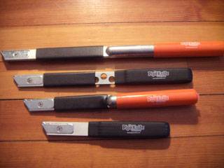

pipe knife its called, its just a utility knife with a super long handle.
