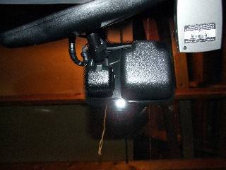

Early build 2004 were the last for the rain sensor wipers, should be obvious black box just right of the rear view mirror and left of my radar detector on the inside and a 4”X5” black area with the LED visible on the outside.
Unplugged rain sensor the wipers should now work like regular speed sensitive intermittent wipers.
Check to see if the windshield has the wiper park heater grid also.
