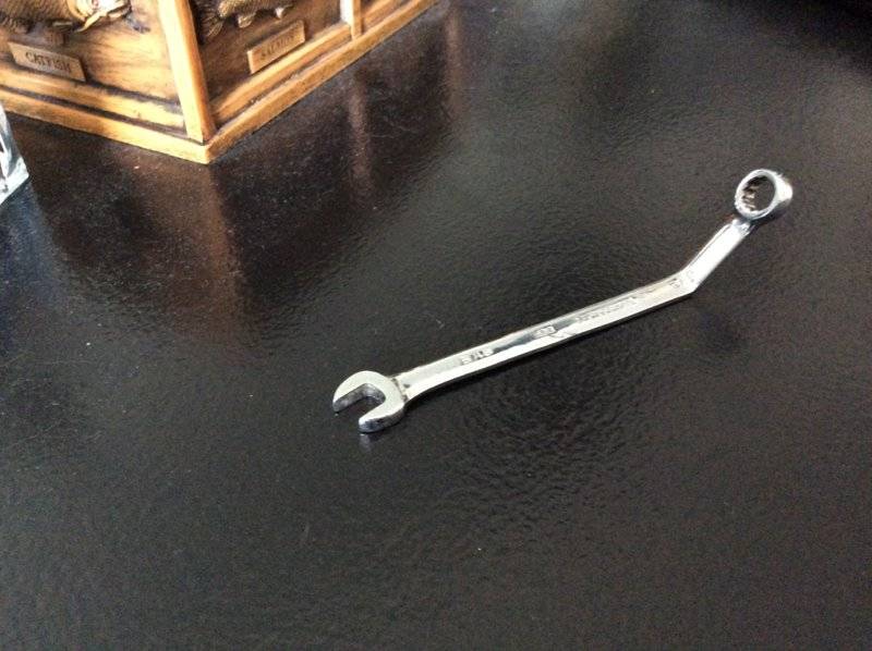

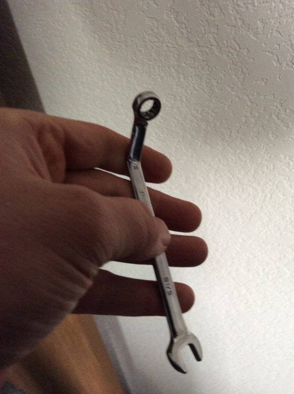

            I bent a 8 mm wrench into L-Shape and it worked perfect then just use a needle nose pliers for the last two-three turns ... If you bend a wrench just make sure it's thin and skinny

            35F3D418-808B-4F1C-99D1-70B342AC9660.jpeg 4E74E0D6-5313-4F21-A2D8-6065476EBD04.jpeg
            I guess it’s a 5/16 but either 8mm or 5/16 will work just be careful when bending the wrench if you bend it to far I’m sure it will snap
