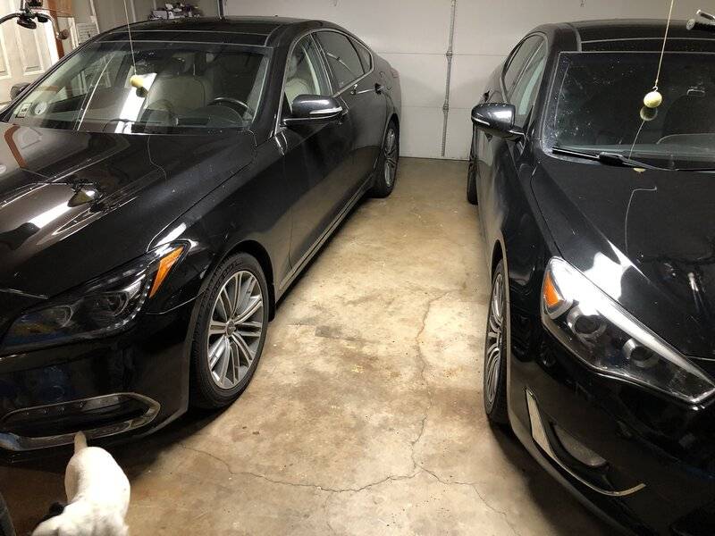

Wow, neat garage Joe. Don't have to back out, just push a button and rotate the car. Please don't leave this site even if you don't have a LS. You have too much knowledge to disappear.
That's not my garage, but a good place to take pictures.
\/ My garage \/

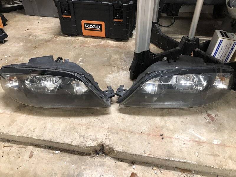

Left and Right gen II halogen headlights. All bulbs good and the lenses are clear (professionally refinished) but the clear coat UV protection is bubbling/peeling.
