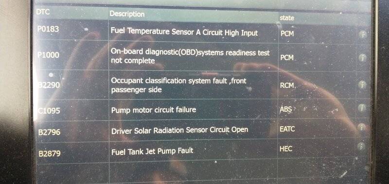

Ok joe I finally chipped away enuf I've and I made it back to the car. It throws 6 codes that's it.
So I'm hoping that one of those is what's keeping this thing from starting
No, the no-start is not related to any of those. You said you had PATS codes. None of those are PATS codes. Even your tool says they are PCM, RCM, ABS, ETAC, and HEC, not PATS. You need to go to step A2 as the chart says.
