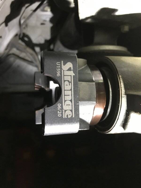

Strange U1596

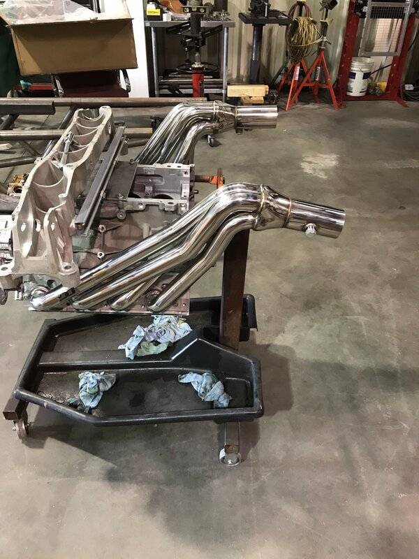

Back to this thing trying to figure out long tube headers. 3rd set might would’ve been close enough to modify except I think they screwed them up slightly, lol.

It’s a strange 1350 pinion yoke.
Although I am very vehemently opposed to the idea of putting a chibrolay engine in a Lincoln, I'll say that your efforts seem workmanlike and neat. Getting use of a plasma cutter will have that support web out of the way of the driveshaft in short order.
In regard to the throttle control, simply get a pedal assembly from an '02 or earlier and adapt it to your car. You'll then have a mechanical pull cable arrangement that can be exploited to match your other components.
