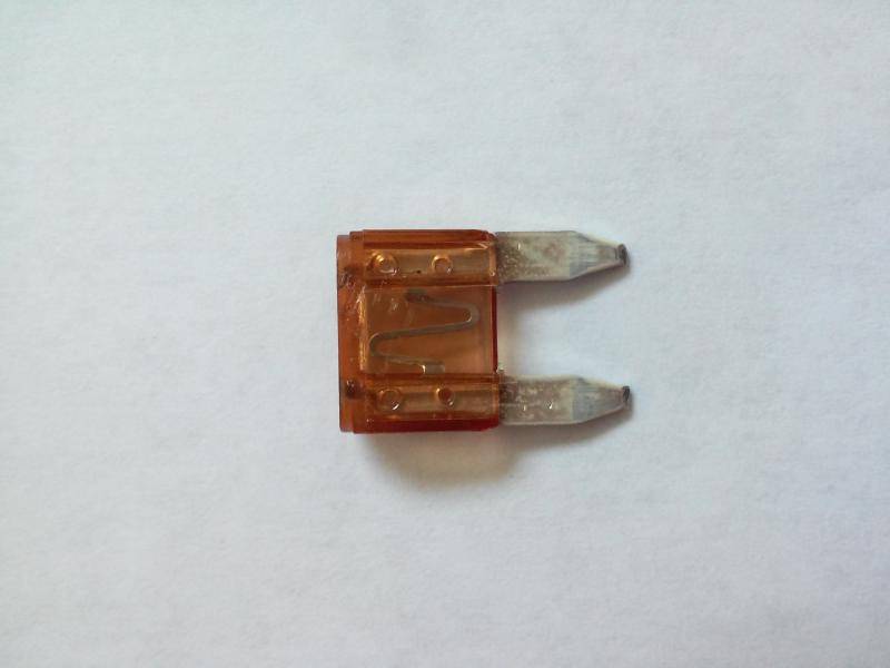

I had the same exact issue (no movement except lumbar in driver side power seat) in my '02 sport. Thanks to this post, I checked the fuse (which my driver's manual describes as "DDM, DSM, Anti-theft LED, Security horn, Power mirror"). Don't know what the first two are, but the driver mirror moves (I assume that's what "power mirror" means). I locked the doors to arm the anti-theft, and the LED was blinking. Opened the one door with the flaky power lock, security horn went off. So it would not seem that the fuse was the problem. Pulled it to examine it, fuse.jpg did not seem blown. Just to be sure, since joegr obviously knows his sh*t, I swapped it for one of the spares (15/28). Sure 'nuff, fixed.
