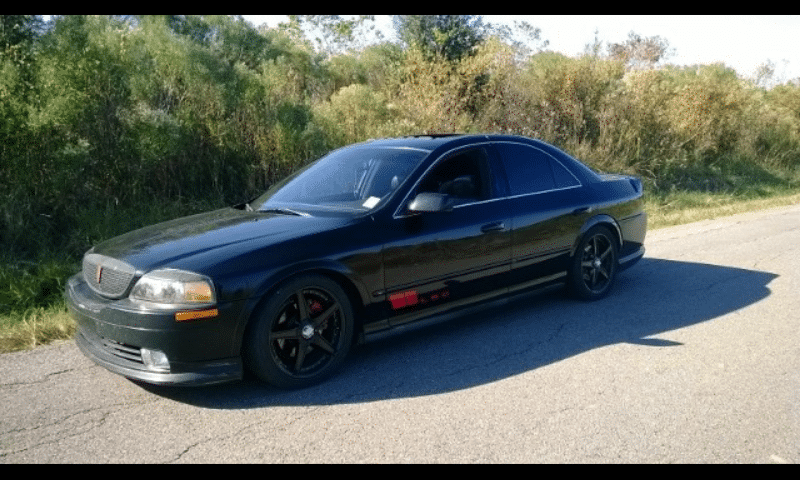

I got my 01 3.9 v8 Lincoln ls in 2008. It was lowered just before it was sold to me. I cannot tell how many ball joints I've been through. Looks awesome but a lot of issues I've had would have been avoided if it wasn't lowered. I refuse to lift it but you should be warned.. speed bumps, raccoons, pot holes will cause nightmares. I once got hung up trying to get on the fairy cuz the tide was comin in..
