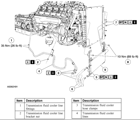

Ummm..there is probably a reason your fluid is all messed up. Trans fluid shouldn't really get ugly...
Maybe you have a leak in the trany cooler mounted in the radiator.
Do the Gen I's have the cooler in the radiator? My two LS's don't, and my general experience is that many Fords don't.
Are you sure? All 4 of our LSes do/have. All 4 of my Sables also had the trans cooler.
Never mind. I see you're talking about an internal cooler........
Yes, there's a difference between having a transmission cooler in front of the radiator and having one in the radiator.
Ford did a big study of transmission problems in the mid 90s. One of the results was that one of the bigger causes of failures was transmissions being overheated when the engine would overheat. One of the recommendations was to remove the transmission cooler from the radiator.
