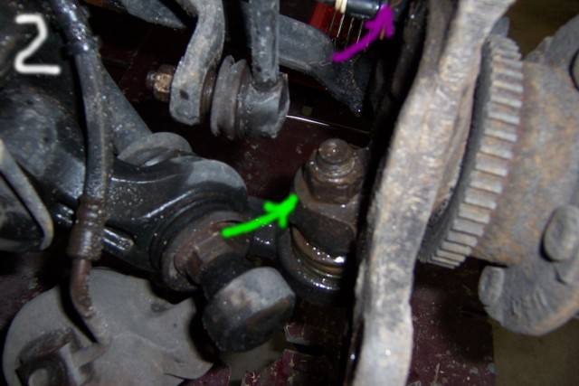

I'm removing the lower control arms on my 95.
I have all nuts removed all bolts removed.
What I can't seem to do is get the arm to drop off.
From where the green arrow is. Do I pound the hell out of it or what.
In Mike's tech article he removes the ball joint itself. I'm not doing that. I'm just replacing the whole control are unit.
I've done this once before and all the old trouble parts came off easy. Damn!:(
Sometimes a slight tap will get them apart, other times...its a battle and a fork works good most times. This is of course since you are replacing the ball joint/control arm, the fork will kill the boot.

If you get the picle fork in there tight, somtimes you can smack the top of the bolt with a big hammer and it will pop loose. ...............

I've never had a problem pulling up on the spindle, and cracking the ball joint down. usually seperates quickly.

First off I got them off last night. Then had too much Tequila.
Had to wack them like crazy with the pickle fork and a 5 lb Minni sledge.
