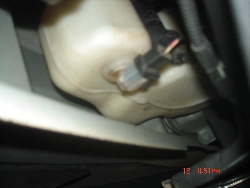

I bought the sensor from Max a month or so ago. It was 12 bucks. Took asbout 6 minutes to change. If you take the headlight cover out from under the hood its on top of the reservoir closest to the center of the car. Its the only thing there with wires on it. Ill try to get a pic tomorrow during daylight if you would like.

Pics
This ones a little fuzzy but....
Pic 2
This ones better. Right behind the grille on the drivers side.

The pics were a gen 2, I didnt disassemble anything at all. But you have an idea where it is now. The second pic is upside down because its the only way I could wedge the camera in.
