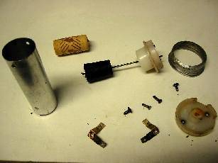

"Then I moved to brake fluid sensor, which gave alert even when container was full of fluid. The sensor looks unserviceable, but actually the rivets are screws. So if you grind slots to them, you can screw them out. The float appeared to be normal cork, which propably has soaked so much fluid during 40 years that it did not float any more. And then comes the joyful part: where can you get a new cork? From wine bottle of course! And a bottle without cork goes bad quickly, so of course you have to drink it! Best repair ever! Restoring a car is fun! New cork in place, everything back together and works perfect."
Don't use a cork. You will have to replace the sensor assembly if it is the problem. (Or, just leave it unplugged and check you brake fluid level often.)
