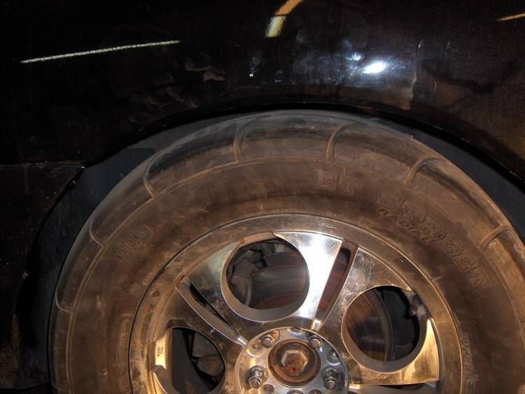

You do not need big sticky meats... I run a 26x9.50 Hoosier QT Pros and have little to no traction issues.

2nd poster, i see what your talking about. Im just going to be running a nitto drag radial. The width is just for more contact patch and looks. Looking at a newer mustang with a 10.5 inch rear wheel and 315 tires is just mean. Do you know the exact stock specs of offset, backspacing etc?
If i cant widen them enough to make a difference, i will at least run a spacer to make the tire flush with the fender. Those wheels are way to tucked in. Do you have any rub issues? Those luanch pics are sick, love the irs squat.

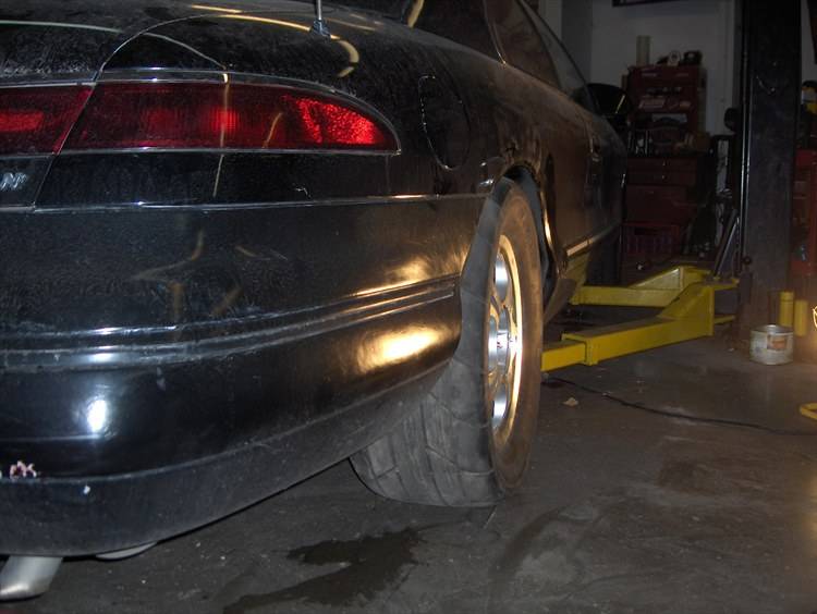

Stock wheels are 16x7 with a 39mm offset. I plan on swapping to an 18x9 with a 40mm offset. You can get a staggered wheel setup with wider rears to work depending upon the suspension setup and if you wish to roll the fenders. Searching the forums, you will find many combinations that have been done successfully.

... Im just going to be running a nitto drag radial.
I forgot to comment on this.
I used to run Nitto DRs. They were the worst tire for the street as far as I'm concerned because they were impossible to keep in balance after burnouts at the track. Now maybe because the Mark VIII is so sensitive to NVH issues, but after a while they really became annoying. Besides, after the addition of the stall converter, they became totally unpredictable in the traction department. Sometimes they would hook, sometimes not.
I got much better results later when I started running Mickey Thompsons ET Street Radials. I only use them for the street or certain "DOT tire" events. But even after many burnouts, the ride on the highway is still good. They hook reasonably well but they are dependent upon track conditions. The best results at the track truly require a dedicated set of track tires.
I assume by suspension set up you mean the ride height? it would be awesome to get 17 X 10 or 18X10 in the rear, possible? Fender rolling will be easy, i have access to the nice eastwood one that bolts on and applys even pressure.

O and about the tires, thats crazy. Usally everyone agrees nittos are great on the street but act like a street tires at the track, unless you heat them up really well. I would also think the would hook great for you given the amount of sidewall you are running and the auto, even if its not that wide. For example, in 17's they have 275 with a 40 side wall and 315s with a 35 side wall. Also i prefer nittos because they last the longest for everyday driving.
By suspension setup, I do indeed refer to the ride height. Running at stock height you likely will not need to roll the fenders as you would with a lowered suspension height.

38 offset,roll the fenders and you can use 275 tires. 50 offset roll the fenders will take 295. i have done the 38 with 275/40/19s no problem. i've got the 50 offset wheels on now with 275s measured everything shouldnt be a problem going to 295s. be sure and use plastic ties to move the e brake line out of the way or it will rub tire,i couldn't figure a way to reroute. if you roll the fenders be sure to use heat gun to avoid cracking paint,worked fine for me. note on the front with 35 offset 255 was all it would take. if you use 38 will have to grind some i bought 47 offset for front without thinking it thru and had to use a 12mm spacer and change studs. that cost a week and $250.
Thanks for the wheel info. How tall is the tire on that 19? Thats a big rim.
rich 88, can the dealer tell you if it is updated (the accumlators) by running the vin or is there no way to tell until you pull it apart?
315/45R16 Mickeys on 16x8 rims. (I wish they were 16x10)
