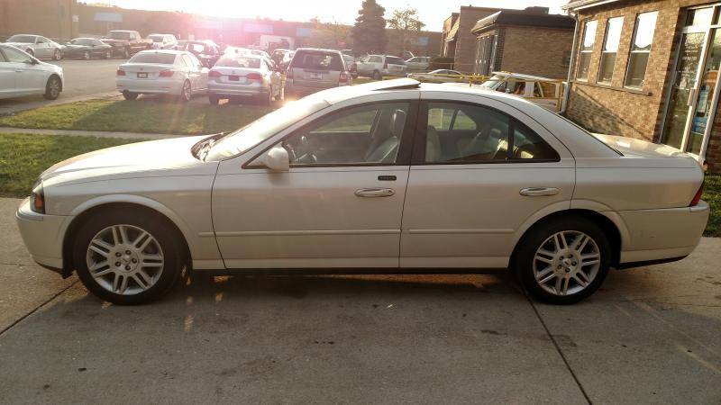

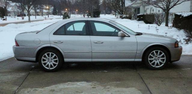

I picked up a set of 17 x 7.5" Jaguar S-type 10-spoke rims (same size and offset as the LS and retro Thunderbird rims) to use with the minus zero size narrower 215/55-17 (same diameter as the stock size 235/50-17 tires) Michelin X-ice iX3 tires on my LS. I got them at BJ's with a $70 rebate at the time. I think that Michelin may have a similar deal going right now. I have used them for the last three winters and just installed them again last weekend (tread depth now at 8-9/32"). I have never had a problem with them or the car yet, including through the brutal winter of 2013-14.

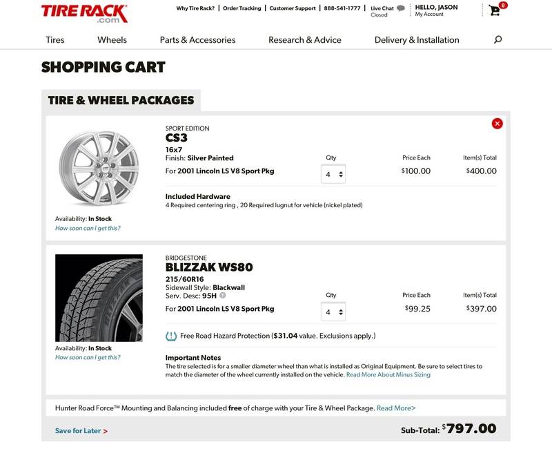

For my wife's 2001 LS V8 I did a full minus size and went down to the 16 inch wheel / tire size from the non Sport models. It's a 215/60R16 tire on a 16x7 inch wheel. They are a decent set of alloys very reasonably priced from Tire Rack and the tires are Bridgestone Blizzak WS80's. This is my 5th set of Blizzaks I've had for as many vehicles and these tires have NEVER let me down. You can't beat them for winter driving.
Sent from my iPad using Tapatalk
