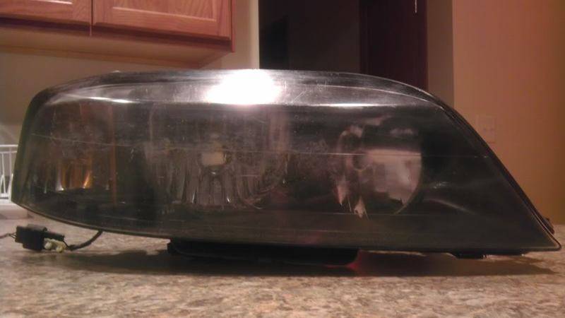

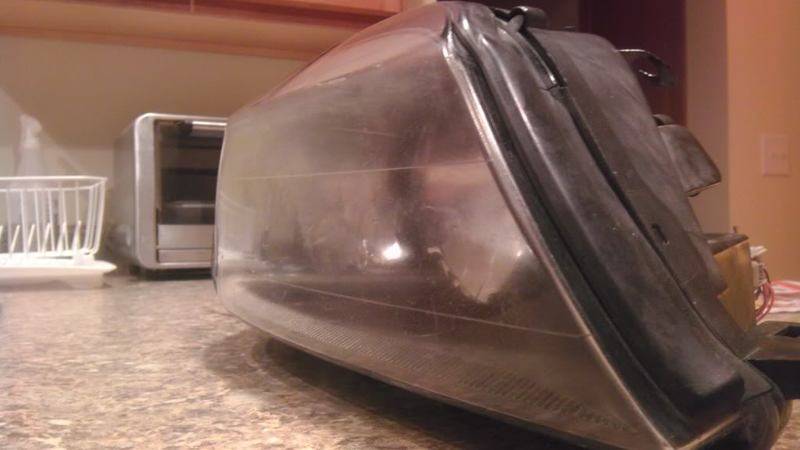

I couldn't pass them up. They work and just need a little TLC to the lens and housing. Going to be my temporary when I go to do angel eyes, and my practice lens for refinishing. This lens is the worst I've seen, hazing and some yellow unexplainable stuff on the lens. Apologies if someone was watching it/came across it. They'll be back up when I'm done with them, in better shape. This will later turn into the thread where I show before afters, install, etc.

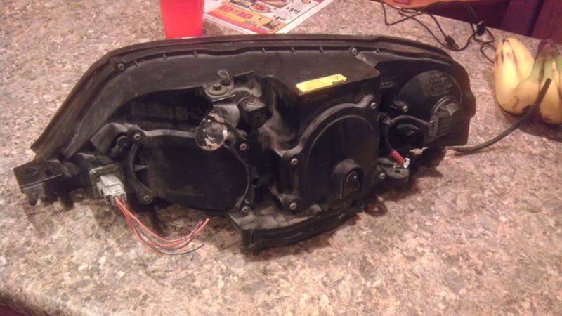

That cat would be pretty sweet. This was more of a steal than a grab. Some people don't know what they're selling. The ballast was labeled "computer". Got nervous when I opened it because it had the ballast covers screws were backed off so I thought the ballast may have been sold separately. I would have :q:q:q:q if it was missing because that's the most expensive part of the assembly.

After closer inspection. The yellow stuff wasn't smeared bug :q:q:q:q but someone wrote on the lens with yellow marker or something. It was not fun wet sanding that off let me tell you.

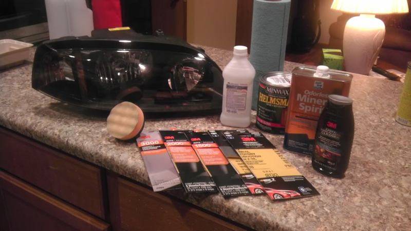

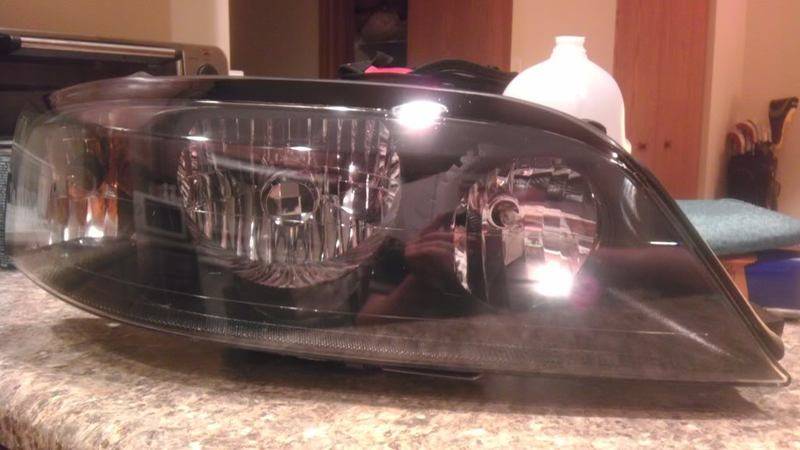

After pics following the above threads directions. I bought the 3M kit but ended up using it for just the polishing pad, found it easier to wet sand it all by hand. Can cover more area with a little elbow grease. Now just to set them outside to cure 'em a bit tomorrow.
That looks amazing! Great work.
